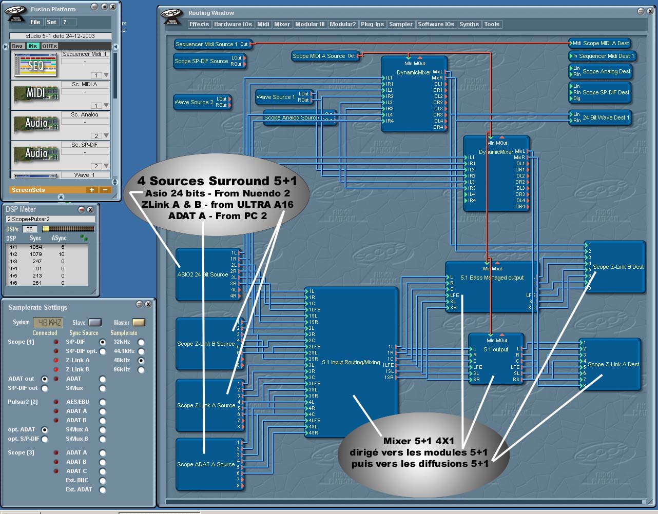

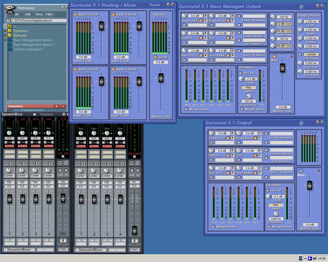

hi jimmy,
i have built some times ago some very usefull tools for 5.1 apps ...
but i think you already got them ... remember ;-)
here are the pictures ...
if you need these devices , just mail me*
cheers
olive
