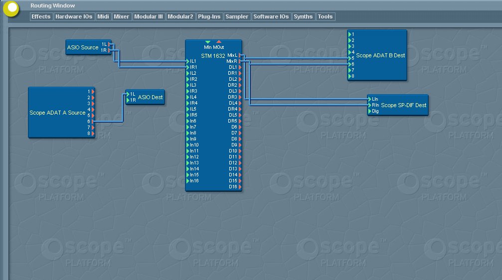

I try XTC mode with this connections. Is it right?

Post by the19thbear »
looks right..
well first of all, try opening the project you posted, and open cubase, still leaving sfp running with the project.. do you have any sound?? if not, the soundcard is not the problem.
If you have sound, save the project, overwriting your existing xtcproject.pro, tick the "xtc mode" in the sfp box and load cubase.
NOW: when cubase starts up, do you see the XTC logo??
would be nice if you posted a little more info: have you got xtc mode working already? can you load scope fx in cubase etc etc? is it only the digital coneections that is a problem??
thanks and good luck!

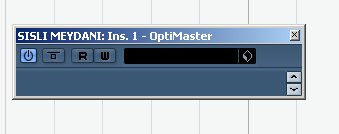

And I try open effect(optimaster) on cubase , but it open like this.
Re: XTC problem
scope is closed when you open cubase, right?

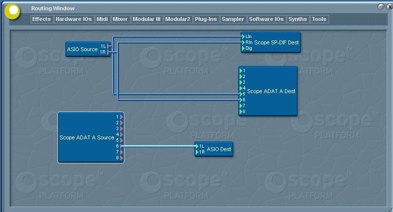

First of all, install sfp with the xtc mode field ticked.
there is SFP mode and XTC mode. You can't run both of them at the same time.If you want to run things in xtc mode you have to close sfp
You can though, test your XTc project.pro: open sfp, open your xtcproject.pro, i would leave out the mixer ( as stardust pointed out), and connect the asio outs direct to your scope adat and scope spdif. ( just to test things.) open cubase, select the ASio scope driver in cubase, playback some random audio and see if you have sound..
If you have sound, it works.save your xtcproject.pro file

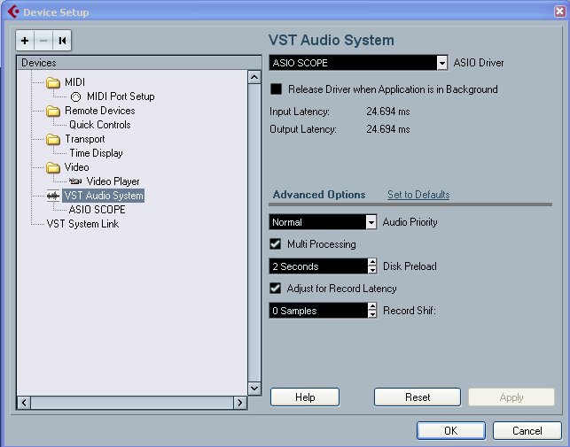

yaeh, I know XTC mode and SFP normal mode different and when I try to works on XTC mode I close the scope program.I checked XTC mode enable.
So I do everythig.I can hear sound while scope working normal mode.But When I close scope Platform and open cubase ,Ican't hear sound.What s wrong, I don't understand :(
Everything like this.
Device setup on cubase
DEVICE SETUP.jpg (53.79 KiB) Viewed 832 times

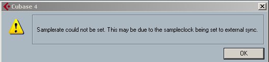

When I open cubase I take this massege.
SAMPLERATE EROR.jpg (11.27 KiB) Viewed 832 times

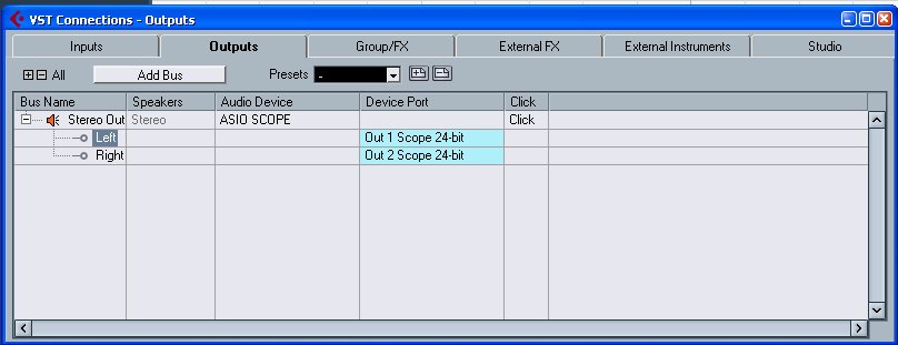

and my outputs...

the19thbear
Posts: 1499
Location: Denmark
Re: XTC problem
go to device setup, and to asio scope. then reset/refresh the ins/outs, go to connection setup (your screenshot), configure the new ins/outs..and restart cubase..

Re: XTC problem
the "samplerate could not be set" message occurs when the Scope samplerate is not what the last samplerate that cubase operated in, or if it is not the same samplerate as the project which is being opened. changing the samplerate in scope or cubase will fix the problem.
