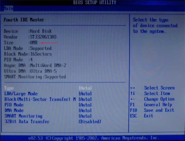

Ken, the P5GDC BIOS takes lot of time at POST, detecting the drive, then beeps an error: HDD failure. Entering the setup, the disk label is listed (but the last 3 digits are spaced from the initial string
); the size reprted is 0.

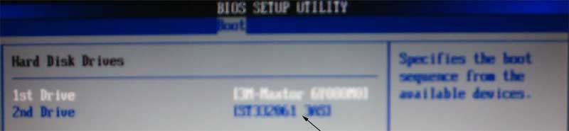

Since the P5GDC displays the drive in the BIOS, there's a screenshot (I took my brother camera, since mine is bad). The drive is connected as SATA, this time, so it's reported in the HDDs list.
