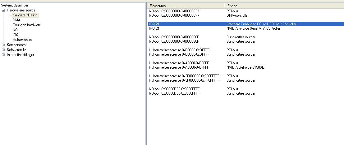

I attached a picture of winmsd/hardware res/conflicts
I use one sata dvd drive, the hard drives are IDE.
thanks!

and, by the way.. took out all usb things except keyboard/mouse.
no errors now, when i put in something in the front usb ports.
guess i'll have to buy a hub!..
