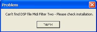

I tthink my Pulsar declare war on me, i canot do anything without a problem.
everytime that i try to load a synth (like vectron etc...) i get an error messege (see atch file).
i tried to reinstall all of the plugins and even the drivr but with no help. :(

If You work for some time after SFP-Setup and only now its happens , ALL You have to do is:
Close SFP
Copy From Setup-Folder/CD "\APP\DSP\*.*" To :
SFP-Folder"\APP\DSP\*.*" (OverWrite ALL)
Re: From one problem to another- Synthesizer load problem.
the file is probably there in Scope\app\dsp. it is most likely marked "read only", which is the cause of the problem.

10x everyone!! i managed to solve my problem.
like LuCiFaeR sad, it was only a currapted file problem.
i copied the files from the cd to the scope dir and the problem sloved!
