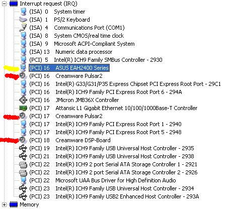

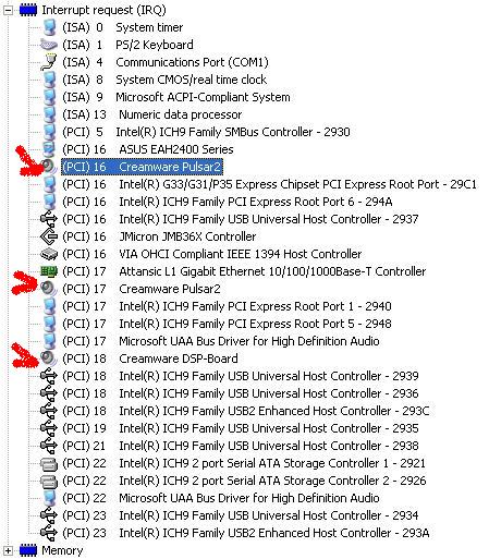

Strange interupsts!
Looks like Scope and Plug-Ins are installed ok (Not tested Flexor yet)
Cubase 4 with latest fix .
When I open a project in Cubase, it plays well -and meters move as the are supposed to on both Cubase and Scope.
Then - after a while I lose controll over the PC, the keyboard and the mouse dies. Cubase and Scope cont. playing, no cracking, meters ok.
Not even a spike on the Task manager.
When i restart, there is no pop-up warning there has been a seriouse error.
I can't find the logic in this error!
Any idea???
PS With Cubase 4 without the latest fix, it seemed ok ......but i'm not 100% sure.
Only other update was Syncrosoft

- luigicampala
- Posts: 112
- Joined: Sun Dec 16, 2007 3:40 am
- Location: Germany
Concerning the dispense mode, look here
http://www.planetz.com/forums/viewtopic.php?t=25301
Another thing is probably if you are running a USB mouse and keyboard they might interfere with Scope, maybe they are sharing the same IRQ, which is quite likely.
Look it up in the device manager. Maybe changing either the USB connections or the PCI-Card slot helps.
In addition to this you can check the latency of your board with this tool
http://www.thesycon.de/deu/latency_check.shtml
Watch for heavy spikes (i have an latency max of 28µs, so you can compare)
arela
- Posts: 858
- Joined: Tue Aug 27, 2002 4:00 pm
- Location: Norway
Thanks luigicampala
- I could not find any dispense mode HKEY_LOCAL_MACHINE\System\CurrentControlSet\Services\USB
The USB entry was not included in this path, though a lot of other usb* folders like usbuhci, usbstore, usbprint etc
- But when it comes to sharing - i got it - big times
One misstake was,i installes all cards - should installed only one and added the other two after install complete.
I guess there aint easy to change IRQ's?
The latency test maxed at 63

- garyb
- Moderator
- Posts: 23474
- Location: ghetto by the sea
you're going to need to disable at least the usb controllers that are sharing with Scope.
good god, you've got a lot of unecessary controllers hogging resources! there's a raid controller and built in audio, not to mention the asus thing, graphics card? you could even disable the pci-e roots if you aren't using those slots, although system controllers like that usually don't make troubles...
if you eliminate all the unneeded or unused controllers things would look a lot better(serial, parallel, etc.)
arela
- Posts: 858
- Location: Norway
Thx luigicampala and garyb.
I did remove a USB removable hardisk (it's for backup, so it should not be connected when it's not in use) and my playing time with Scope and Cubase raised from approx 15 min to approx 80 minutes
The strange thing is the PC seems running perfectly with wave drivers.
I'll test more on that.
The Asus thing is a PCI-e graphic card
I need USB for
2 for 2dongles
1 for mouse and keyboard,
2 for midi -UC-33 and keyboard
I'll try to remove RAID and Audio first

- garyb
- Moderator
- Posts: 23474
that's not how usb works. one controller can handle several usb devices and ports. go ahead and disable the controllers that are sharing irqs after disabling the unneeded stuff.
that's an unfortunate design that ends up with pci-e and pci slots sharing irqs. likely there won't be a problem after you finish the job.
