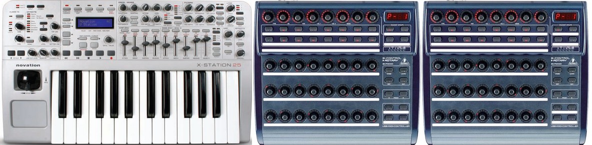

The idea would be to allow extensive use of MIDI controller unit like MIDI controller keyboards or MIDI controller (especially in my situation: my novation X-station and couple of Behringer BCR-2000 which offer me : 150 + 110 + 110 = 370 midi control elements).

Just to illustrate what I mean in term of MIDI controller setup, here is mine ...

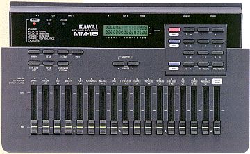

PS: I also have an "old" Kawai MM-16 used for main mixer control (16 channel volume).
- Mixer control additionnal midi controller
- mm16.jpg (24.09 KiB) Viewed 3866 times
- Device control setup:
370 messages available, can be splitted to control 3 devices but would also be fun for a complex one.... - Hurolura control surface.jpg (127.85 KiB) Viewed 3867 times
