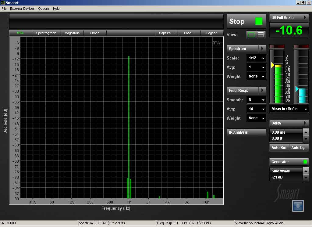

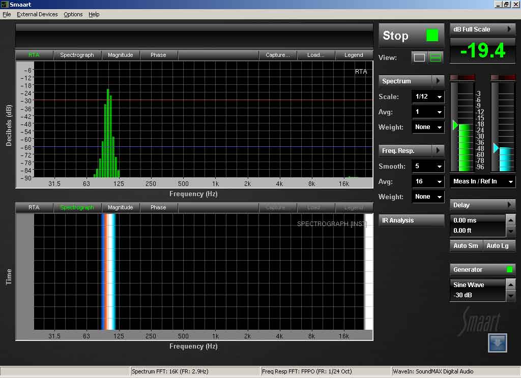

Well here is the same sort of thing from my cheapo audio laptop card:
@ Gary - It's all internal Gary.
Sideband 100Hz
Sideband 100Hz
Sideband 1kHz
Sideband 1kHz

Ok, I set up a sine wave to pass through the audio drivers which is picked up by the spectrogram.
What I am asking is, why is the spectrogram showing sidebands when the sine wave is supposed to be a pure signal.
I tested this because I was getting some "fluttering" affect. I've just replaced the drivers and everything sounds as clear as a bell.Yes they were corrupt.
The wierd thing is that I still get the sidebands as a result. They are very bad in the Lows and lower mids and begin again at about 15.5kHz.
So my question is: What noise is being added to the audio signal?
I can't believe how bad the sound was and how flakey things got when the drivers were corrupted.

tgstgs
Posts: 526
Post by tgstgs »
tricky thing a fft is;
there are no sidebands at all;

tgstgs
Posts: 526
Post by tgstgs »
i dont know spectograph;
but what i see (the bands around 100Hz or 1kHz) is a mathprobl. _ there is no noise!
the fft doesnt care about frequency its a mathmodel put on;
use a higher N to get less 'noise' or apply a window before fft;
if interested do a search for _ julius von hann _ hanning window _ to get an idea
good vibes from vienna
