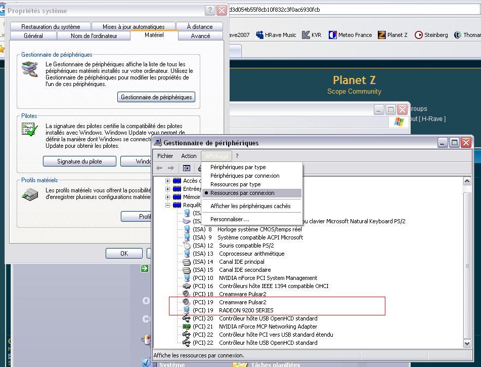

And of course the the classic scope/graphic irq conflict don't forget that one.You didn't mention them in your post.Having said that I have some problems in xtc mode??

Here is my IRQ settings:
There is my ethernet controller (motherboard's network card) sharing IRQ with my Scope Professional. Could this be causing a problem? How can I move it to a different IRQ?

yeah, it could be the shared irq.
moving to the other slot might help, so might disabling unused ports and devices...
