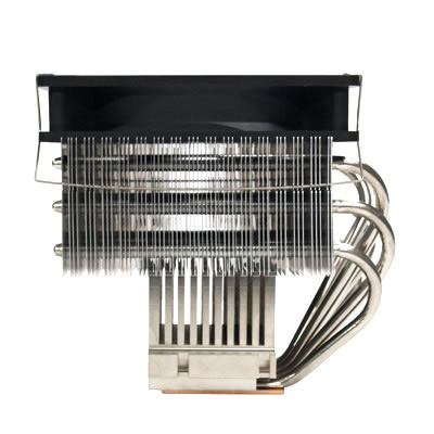

If you have the space in your case, scythe infinity. otherwise scythe "andy" or Thermalright Ultra-120 eXtreme
The q6600 can get hot enough to get that horrible intel heatsink/fan really going loud, and they do get quite hot. TDP is over 100 watts.
I have some 140mm fans on order to see if that helps even more. I dont use loud volumes most of the time, so i need the machine to be quiet!

I have scythe coolers in all of my PCs now. i would go with one of those, they are relatively inexpensive, they dont have LEDs or shiny plastic crap on them. you can put on any fast or slow fan you like. and replace the fan if it gets noisy or dies. and they work well.
I did a mini review of one here.http://www.planetz.com/forums/viewtopic.php?t=24489
if you have a fireplace you can get rid of most of the upright piano if its not any good
then take the steel part to the scrapyard for $$$$
or if the wood is nice, you could re-use it and make another piece of furniture.
such as take out the guts and put a keyboard or synth there, and rack mount where the upright part was.

well the "andy" is a down pointing one. and the lower part is small to clear all the capacitors and stuff. it fits fine on my C2SBE which has almost exactly the same layout as your board. the only thing is. if the power supply is next to the board like mine is, you might have a tough time getting at the rear top(right) intel annoying snap fit thingy. i ended up taking out the power supply to get at it.
There is also the "mini ninja" which performs quite well and is meant for cases with less room, but then you have to use a 80mm fan, none of them have enough airflow to be quiet with a Q6600under them.
Thanks Neutron.
Scythe Andy looks promising especially as it can be installed in four orientations so at least one alternative should be ok.
There's not much room around the processor socket,the MCH with its ~7cm high cooling fins is about 2,5cm from the edge of processor socket (downwards when installed) and towards the front direction of the case there is a capacitor (I think) standing again at something like 2,5cm distance from the processor socket.
Anyway, there's enough room around the MoBo in the big Antec Titan case. And enough options for additional fans if needed.
Now I'll have to check if I can find this Scythe model at our retail shops here. If not I'll contact pcsilent.de or some other German online shop.
Thanks again Neutron.
Cheers
-k
Cheers
-k
If it happens to not fit because of the MCH fins, you can put a smaller one, because the big fan will blow on it.kaju wrote:Thanks Neutron.
Cheers
-k
