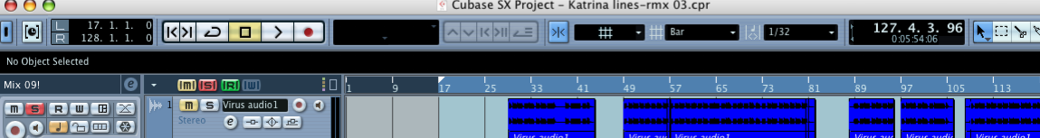

what Cubase version are you on?
I thought old VST 5, but according to recent posts you're using (even) SX v.4?
In Cubase VST5 (snap, bar) and in SX v3 (see blue >I< and window 'bar' ) it looks like:

it's simple, you will have to activate 'snap-to-value', ánd you have to define at what snap resolution you wanne work, be it one bar, one beat, 3/36e, or 'use quantize' in combination with note or free value.
if you have parts of which first note starts on an off beat ( >1), then quantize the start of the part one a bar position.
(drag the start corner of the part to the left while having the quantize value at 'bar' with snap activated.
This way copying is much easier.
