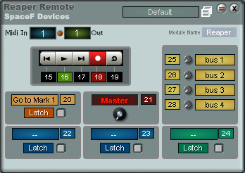

Reaper Remote is a small midi remote controller that can be assigned to any keyboard shortcut of Cockos' Reaper
Made to be light and simple, mainly for transports and a few locators.
Please download and read operation instruction on this page
It can be handy for those who want to avoid switching back/forth Scope and Reaper, while accessing some Reaper's transports and other essential functions.
- Can also be connected to spacef mixers/MultiSynths "p" out pads.
PS: thanks to Cockos Inc for permission of using the transports graphics ;-)

If my memory doesn't fail, there is such a device, probably as a MIII patch or module. It's called "sequencer remote" and it uses MIDI instructions to trigger the commands.
It's much more basic than this one, but for simple recording it works fine, unless you use SONAR 4 that doesn't allow to map these controls to MIDI instructions :lol:
spacef
Posts: 3364
Post by spacef »
I still have the "sequencer remote" in the Midi Folder of my Scope 4.0.
The "reaper remote" midi CC can be changed (they are totally arbitrary, as reaper does not have midi CC numbers assigned in advance to such and such function; assignment are totally free).
You can also change the name of the module in the "module name": it will change the name of the module in the project window.
Does cubase allow assigning CCs to transports and other features ?
If any other apps can receive midi CC, then the Reaper Remote can be used: just change the CC number, labels etc to customize it...
I don't have cubase 4 so i can't tell.
MAy be somone could try to find how it works, and either tell me, or make a preset for the device?
Reaper opens at least 10 times faster than Midi OX that's what i really like in this app, it doesn't clog your ram ....
