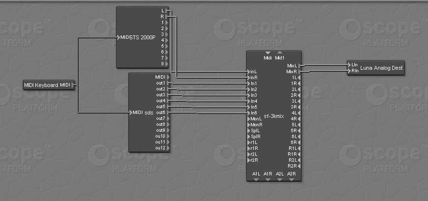

Okay, ive got scope running and can bang out some masterpieces with this little home card(mmmm dsp chips), But i havent the chance to do just that because of the freezing while composing bit going on here.

just the scope midi keyboard, i tapped a few keys and it froze
All Scope by its lonesome.

p.s. as of the end of this post i will further eliminate the scope keyboard split to the 2 samplers and feed just one.
