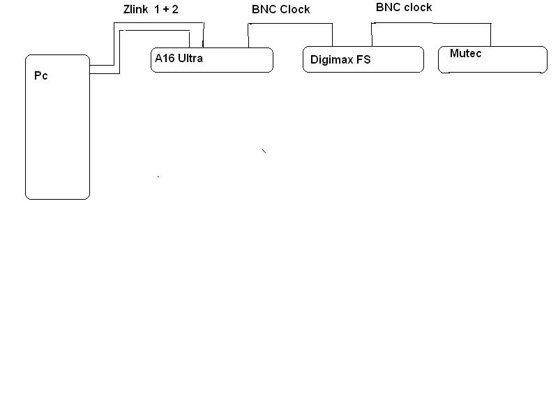

How do I synchronize machines?
Post by nunziata »
Samplerate scope of the errors I
As devop do?
Whereas outboard
Scope DSP 15
Zlink connected with A and B ultra a16
Presonus digimax
M 1000 Roland mixer
And a signal distributor MUTEC 1 in 8 out?

start off as the scope as master with adat and syncronise the a16 ultra the presonus digimax off that, maybe go out of the digimax with the bnc into the mutec, they will all have to be switched on of course, oh and don't panic, unless you're recording the rolling stones and then you can panic.

maybe. you can use the A16 via z-link to the monitors or you can use the analog or sp/dif connectors to the monitors depending on how you set up your project. Scope is a virtual reality patchbay. connect as you please.

Perhaps we need to set 16 as the master if you want to use the 16 channels
no the A16 doesn't need to be master. if you are using the syncplate, the connections are external bnc. within scope, you select bnc as master, OR if scope is set to master, clock will be transmitted through bnc and adat.

you don't need to do anything special to sync samplerates in the project. no syncplate module is required.

Ok but who is the master?
