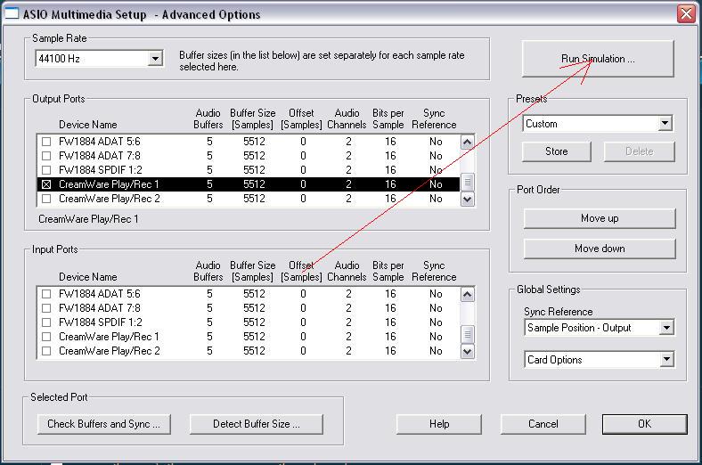

If I have a doubt I usually go into the asio multimedia setup and do a syncronisation check, sometimes it gets wierd because of that as well.
- Asio setup.JPG (81.71 KiB) Viewed 2940 times
Thank You Brotha' Man H-Rave,
