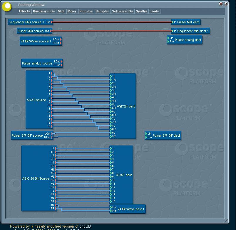

A study with 48 channels microfoni balanced WITH patchbay Signex palladium for routing)
1 PC. SCOPE DSP Z-15 LINK
SOFTWARE ASIO NUENDO
A16 ultra Creamware
2 drawner noise gate 201 4 channels
1 lexicon pcm 91 2 channels reverb
1 Mutec for clock
Remote controllers Frontier Design TranzPort
A 80 Masterkeyboard Roland MIDI
Project which is more 'suitable equipment to handle this in a flexible and convenient?
Annexes eligible projects.
Thanks to all
this is tips project
adat or zlink in asio.jpg (91.58 KiB) Viewed 20947 times

Thanks to everyone and especially to GARBY and HRAVE
Everything worked.
Thanks to exist
