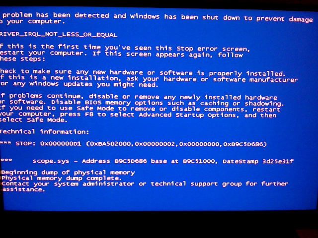

Hi there,
I'm having some serious issues with bluescreening right now that I'm linking to Scope
Information:
PC running AMD Athlon 64 x2 6000+, ASUS M2N32 PRO mobo, Seagate 500GB SATA II hard drive
Windows XP pro (sp3)
Pulsar project card
Sonar 6 producer
Scope 4
I've had it hang and bluescreen several times in the last two days.
I've only just set up this new PC, but I've noticed I get these problems since moving to 24bit recording and 48khz
I'm getting the following message when it bluescreens:
DRIVER_IRQL_NOT_LESS_OR_EQUAL
Stop 0x000000D1(0xBA502000, 0x00000002, 0x00000000, 0xB9C5D686)
SCOPE.SYS- ADDRESS B9c5D686 BASE AT B9C51000, DATASTAMP 3D25E31F
Unfortunately I need to fix this issue urgently as I have studio time booked out already (Thursday) and if it cannot be resolved, I will have wasted a lot of time and money.
Please advise as best you can. Thank you for all your help guys!
John

Hey guys, here's an update:
Nothing we've tried has worked so far.
- there were IRQ conflicts (with our NVIDIA graphics card), but thanks to XP it's been a chore to change them. finally though after some disabling of IRQ hogging items, we got the Creamware card on a solitary IRQ. Still bluescreening though.
- we do not have another PCI slot on the motherboard.
- we're using scope 4, so we haven't got the "scope_v45/app/bin" file structure.
- I did a search for the "cset.ini" file name and got nothing.
- I've changed the latency within sonar and still nothing.
- am just about to clean the card. will update you I'm sure.
I'm booked into a studio tomorrow morning and have already wasted a massive amount of recording time with my guitarist with this issue... not totally sure what to do.
My next thought would be to get a new video card as I suspect it's still conflicting.
thank you for all your help so far guys, but... help!

hi there, thanks for the help (again)
I found the cset.ini file but cannot see "intBlksize" or anything relating to the latency within the file. (nor "hw")
we're also not using ULLI. (our setting is 23ms @ 48khz)
One thing I should also mention is that it's not an immediate bluescreen that happens. I've been able to do an amount of recording but randomly it crashes/bluescreens.
this can happen anything between 3 / 4 hours through to as soon as we start using sonar.
Cheers!

back for more guys!
have cleaned the card and made sure it's sitting in the slot ok:
still bluescreening.
have deleted and reinstalled drivers several times.
smacking my head against wall.
bad hardware....motherboard, memory or video card...
