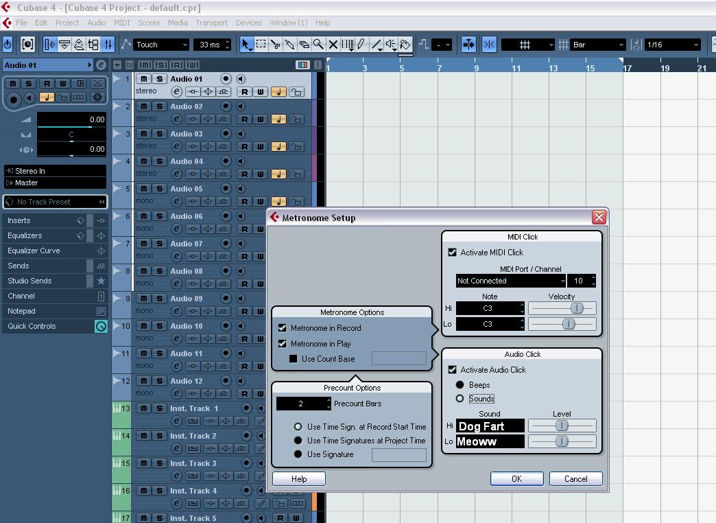

Is there anyway to choose different metronomes in Cubase?
The sound of this thing is so annoying.
After years of a " click track" w/ a splash of verb on it, surely these expensive apps can have other options than this one.
with midi, you can use any sound source for the metronome.....

or you can load samples from within the metronome menu in cubase ( version 3 and above i think). I do that alot. or route it via midi to LM7 drum machine..
