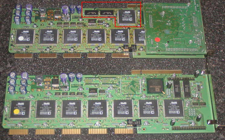

yeah the actual real "14" has an empty part on the circuit board where a sharc and 4 RAM chips are on the "15"
(i just noticed the scope 15 card has RAM chips on both sides, total of 4, the pulsar has 2)
so pulsar 2 has ram, 2 chips some scope have 4 chips and some have none and the ones who have none also have a SHARC taken off, which probably runs the RAM in the background.
