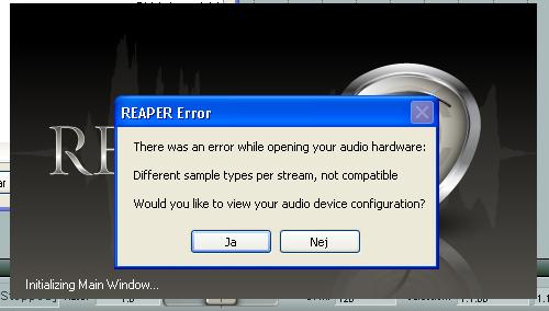

i just tested reaper in xtc mode... but it crashes and wont load xtc fx... did anybody else experience this? or maybe it just doesnt work in xtc mode!?
this is the error message i get right after i open up reaper and my xtcproject file has finished loading.

updated first post with picture :)

Does XTC-mode work in other applications?
My initial thoughs are that your ASIO source/dest modules are of a conflicting type.
Please post a picture of your XTCproject.pro.

it works fine in cubase in xtc mode..
but i'll play around with other asio modules and see.
thanks alot!

Always use the correct destination module with the chosen source module.
Try 32 or FLT. REAPER should support those. It wasn't too long ago that REAPER couldn't read floating point-drivers.

Reaper can work with ASIO2 24bit module in XTC mode.

I always use some form of 32-bit driver (32 or FLT). I don't want any truncation or dithering to happen at the ASIO stage.
