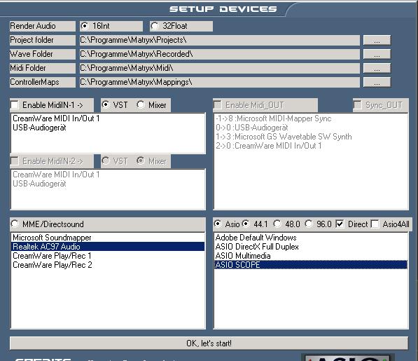

hi
i tried the demo
but crash if i select asio scope driver from the setup
tried different asio modules in scope ASIO2 24 Bit Source and ASIO Source
with the sameresult.
used setup
used setup
lg widy

widy
Posts: 175
Location: Austria-Graz
Post by widy »
Hi
i dont know anything about cubase 4.1
i use old one sx3
in cubase 3 i can sitch on/off asio and i can switch different asio modules in scope on the fly as well if i selcet the driver in cubase again.
But if i select asio in matryx i get a pup up with an message
Error:ACCESS VIOLATION Your work will be save to recover .....
No more Info. Looks like a null pointer, maybe more info with a debug version :)
lg widy
lg widy

hi
i wrote you a mail with screens from my setup
asio flt modules seems to work with matryx ...
matryx wont crash after setup the scope asio drivers
but i did not hear any sound if i load a demo patch or what ever
siriusbliss did you get a sound out from matryx ?
ps:
i only get a sound if i switch do mme direct sound driver ac97 driver
lg widy
