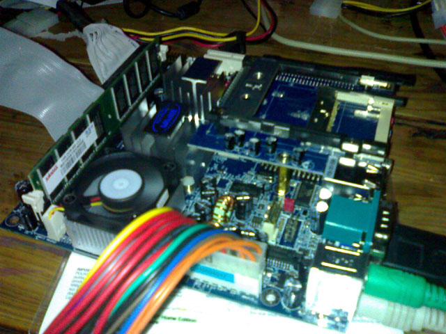

hi all,
like few (many) of you (us ...) i am wondering about eath planet care and energy saving !!! so ...
i am building a very very low consuption PC, based on a mini itx main board that works under 12 Volts DC ...
the main power consuption stage is the HD ...
so i am trying to install winXP on a bootable 2 Go Compact Flash memory ...
Any of you, could tell me what not to install ... how to configure in order to get a winXP usable, with a SFP 4 on this 2Go drive ...
when i usually install XP i got something like 1.8 Go ... can it be less, much more less ??? but with scope fusion working !!!
i wil post some pics and tell you how it works (or doesn't) ... what we can and can't do ... on this thread ...
cheers
olive

Hello Olive!
This is very interesting, and I have also been thinking along these lines of low-power consumption for a scope system - mostly so I could have scope on my sun-powered caravan while travelling / camping.
How are you addressing the power for the VGA? It seems to me that a good way would be to have a laptop pc with a Magma box. This way, the pc takes 12v directly, and you get low consumption on the screen and the cpu (laptops are 60W-90W). For Scope, the magma 1 and 2 slot models can take a 12v PSU as well (I have experimented with an M3 120W 12v DC/DC PSU and 3 scope cards, it has all sorts of surge and over/under voltage protection, and it works really well).
In my system, this adds up to less than 200W for the whole compter system - but then you have to add the sound system, even if only a headphone amp. A "flash" hard drive could lower this even more... Of course, magma boxes are much less performant than onboard PCI, and if you're using a MacBook Pro, you have to select a model with the latest (pericom) chipset, or it just won't work.
As for installing Windows, you can use nlite and build a custom installation disc and remove all services and drivers you don't need (as well as adding your own) so as to get a smaller instalation size. With the addition that you can preset all the tweaks to the system, and it will install everything the first time.
Hope this helps. It's a good cause to decrease our dependency on energy, and if we can rationalize our studios, it will be possible to run them effectively with alternative power sources.
Cheers!

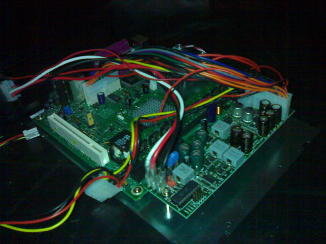

well, I've built such a box in a 1 unit rack case with a PCI extender to turn the card 90 degrees.
Mostly because I wanted an old Pulsar (4DSPs) as a dedicated guitar processor.
The VGA is onboard, so that's not a problem.
there are some pitfalls, tho...
the industrial 1-unit rack cases for ITX boards fit only a short card, I had to cut the front cover to get the card inside - it's less than 1 cm missing.
With a 6 or 14 DSP card you need a deeper case - dunno if it's available for ITX mounting.
the PSU that came with my N10K probably was too weak to feed the extra PCI card, at least I had a hell of EMV noise, making the system completely unusable.
Onboard audio (Pulsar unplugged) was perfectly silent,tho, so it's probably the power regulation due to overload.
With or without PCI extender the noisefloor was about -60dB regardless of the OS.
Strangely there was no noise when I verified the board's PCI performance (a VIA thing, but 4 Masterverbs with a P1) before I ordered the rack case...
As this left me with the option that the board itself might be damaged, so I didn't invest in a stronger PSU.
Instead I put the Pulsar back to it's compagnons in a non-mobility rack on a regular Pentium 3 board.
The system disk is a SanDisk 1GB Flash Disk (an ATA plug with memory inside) which performs very well and reliably for > 1 year in different boxes with Win98 and Win2K, using PCLite and XPLite - for simplicity I prefer the commercial versions
A 'normal' CF card in a disk adapter will usually drag the IDE bus down to interrupt mode. Mind you - both channels
Only recent ones (I noticed it first with the 266x type) can do DMA.
It depends on the interface inside the CF disk, but there's no indication what's inside, so it's a trial and error process.
I haven't tried the latter (Transcend 4GB) as system drives yet.
Same confusion applies to USB Flash memory - a wide range in performance.
The fastest I found (Buffalo) write 700MB to the stick in 45 seconds, just to give a figure to compare.
Be prepared for 70 Euro per 4 GB (currently), the cheapos are lame for obvious reasons...

Jimmy, the extender was a specific type for the motherboard I used to fit to the backside of that specific 1-unit case.
Electrically it looked like a straight-through connection.
But that's different if you want more than one card, you need special adapters for the mobo then - but afaik Supermicro is probably the best choice in this domain.
If an extender exists at all, then with SM - as they have lots of server boards out there.
I'd rather prefer a regular 3 or 4 units case though, as the backside needs specifically drilled and cut openings and server cases are usually way too deep.
Imho you can use a board with onboard video without sacrificing performance, then you don't have the problem to be too close to the graph card.
btw I've placed a Pulsar right beneath (1/10th of an inch) a GForce 8600 passive.
At least it did get fried immediately... but I wouldn't hold my breath on it in a closed case...
it was a super cheapo (65 Euro) Gigabyte 946GMX-S2 (whatever that means) with a Realtek ALC888 codec that seems to have a stunning audio performance at first glance

hi,
here are pics to let you understand the hardware i use ...
about power consumption :
after having measured the power, i noticed that using a CF is quite the same as using a 2.5 HD !!! i thought at first it would be a great difference ... but no !
only 0.1 A under 24.1VDC !!!
so the interest of CF could only be the use in "difficult" conditions where a HD could be unstable ...mechanically speaking ... in a car, a boat ...
here are some results : (under 24.1 V DC)
masure is done under the BIOS after i has been stabilized (30 sec)
by experience , it is less under windows (not working , just "waiting ")
A -- intel mini itx board (1.3ghz / giga DDR 400 / 1 PATA SLOT / 1 PCI SLOT / USB / GIGALAN ...) + M1 PSU (very interesting psu , with few working modes ...)
- with 80Go 3.5 HD = 1.18 A = 28.5 watts
- with 80 Go 2.5 HD = 1.04 A = 25 watts
- with 2 Go CF ( bootable via a IDE>>CF adapter) = 1.03 A = 25 watts
B -- Epia VIA vith c7 1 ghz / GIGA DDR 400 / 2 IDE / 1 PCI / USB / LAN / 1 CF DRIVER (not bootable) / 1 PCMCIA SLOT (good for magma !!!)
- with 80Go 3.5 HD = 1.28 A = 31 watts
- with 80 Go 2.5 HD = 1.04 A = 27.2 watts
- with 2 Go CF ( bootable via a IDE>>CF adapter) = 1.03 A = 27 watts
not tested yet : 8 " TFT Touch screen display that works under 12 VDC .
very nice display, i already use it in my car for my carPC ! GPS / audio / video ...

- intel board with 12 V PSU
- 23122007275.jpg (81.03 KiB) Viewed 3355 times
- via epia board
- 23122007276.jpg (103.37 KiB) Viewed 3355 times
- cf and cf adapter
- 23122007277.jpg (83.04 KiB) Viewed 3355 times
