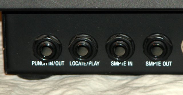

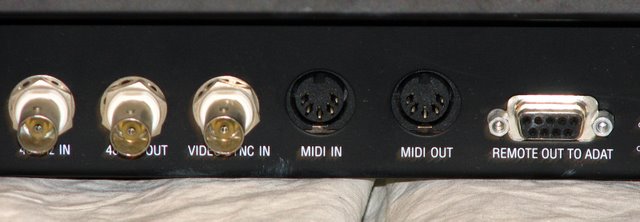

I wonder if it can be used with 44,1kHz?
There seems to be one 48kHz in and out...

- IMG_1392.JPG (26.2 KiB) Viewed 5589 times
- IMG_1393.JPG (30.21 KiB) Viewed 5589 times

Possibly it's indeed related to the sample rate, as Janni points out with the pictures - the BNC is labelled 48k...

The more you look into this it's got to be worth a try if you're getting the BRC for peanuts, but it definitely seems like you'd need to run Scope at 48kHz unless you don't mind the difference in song positiion time that you'd get running at 44.1. Really though, it's maybe only worthwhile if you plan to use an ADAT or 2 as well, in which case you'd have a BRC > ADAT/s > VDAT setup as opposed to a VRC > VDAT > ADAT/s setup, but either should work. I can't understand why Immanuel had the locator problems. Did he not get it working in the end then?
