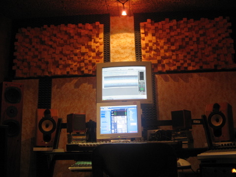

my litte project studio

ooopss,too big
sorry but i don't know how i can do
if you resize the picture down to 30*20 cm or so the text stays readable on the monitor screen :-)
edit: you need a picture editor like paint or Photoshop or a Picture Viewer with edit functionality.
Resize the image (20*30 cm or less), and fix the pixel resolution to 72.
Make it a jpg.
choose a picture file size of 30 to 100k for the web.

is it ok?
nuove nogravity0011.JPG (70.82 KiB) Viewed 3419 times
perfect :-)
now you just have to remove the big one, as the thread is still conditioned by the (biggest) picture.
Scroll to the right (yes...it's big...) and click 'edit'.
Now you can delete the attachment.
you can also edit the post with the picture and replace the original one with the small one.
as long as you're post is the last one you can delete a complete post in edit mode :-)
