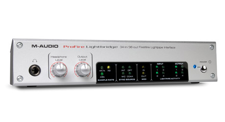

hi jimmy
look at this
http://www.m-audio.com/products/en_us/P ... -main.html
you don't need to install any pci card .... this mean that it can also work with a laptop !!!!
you can send/receive 32 ADAT via 1394 (firewire)
i have not tried it yet ... but will do it soon !!!
cheers
olive
look at this
cheers
olive
- profire
- profire.jpg (15.03 KiB) Viewed 3476 times

Hey Jimmy!
I'm using the m-audio profire at the moment with my macbook and
logic 8 & live 6 and I have to say it works great! (profire ist WC master)
But I'm sure RME does the job ways better and much more stable!
There's only one advantage of the profire: it's portable...
But since you will use a racked pc, I'd definately vote for RME since
it's absolutely rock solid with smallest latency and under full!!! channel usage!

hi
as far as i understand ... jimmy simply needs to route few audio outputs from a 64 bits VISTA DAW to his scope system ...
i didn't tried the m-audio yet but i will try the one of one of my friend soon, next week i think if i got time , but he regularly records 24 / 32 track with it ... using 2 A16 as converter ... synched via BNC WC ...
so , for this cheap price ... it could be a good alternative ...

@ jimmy : how to use it :
[ DAW 1 (64bits / Vista) ] < ------- firewire (32 busses)------> [ M-audio Profire ] < ------ ADAT (8 to 32 busses) -------- >[ DAW 2 (Scope - 1 or two boards with {24 ADAT I/O Plate} or {2X Classic or Plus I/O Plate} ]
