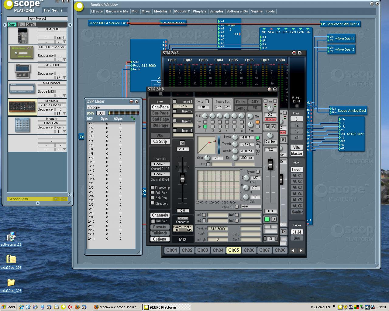

Has anyone seen this before? Note how all the devices are loading in software but not onto the boards. No error messages appeared.
DSP Not Loading
DSP Not Loading
Scope not loading.JPG (237.76 KiB) Viewed 2287 times
sure, reselect the samplerate to reload dsps, or restart scope. you had a pci overflow or other problem and hadn't reset the system yet.....

Thanks for response garyb. Mmm - that is what I thought to, but changing the sample rate has no effect (the sample rate box remains blank), going from Master to Slave has no effect. And I have reloaded SFP a few times and rebooted the machine all to no avail...
I thought maybe its time to clean the contacts but I at least expected a dialogue box telling me about communication errors. This is most bizarre!

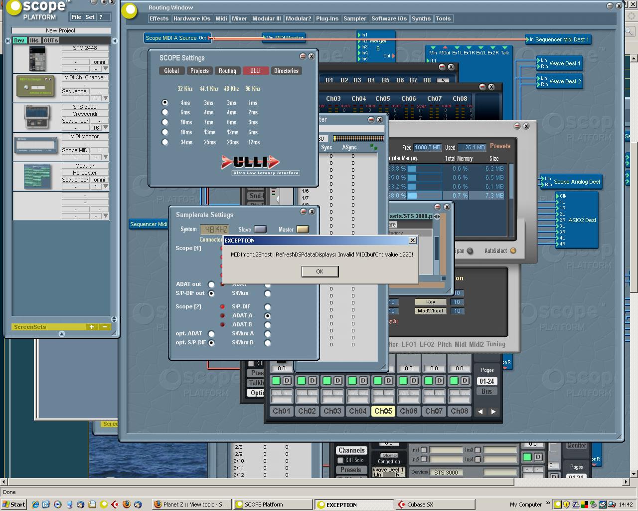

After changing the ULLI response time SFP started to talk to me...
Scope Exception.JPG (217.84 KiB) Viewed 2274 times
that box was probably hiding...
perhaps you have a corrupted project or the midimonitor module in that project is corrupt. try removing the midi monitor and resaving. it may work then. then try to put the midi monitor back. otherwise, i'd try to just shotgun the program. shut down scope and reinstall scope over the top of the old install and restart scope.

Thanks. Methinks it might be time for a complete reinstall...

Yes, it does. Didn't matter what projects I loaded the devs didn't go onto the dsps
try running the installer over the old install. likely this will fix the corrupted file and make things work again(shotgun method). you can still back up the device and preset folders, but installing over the top shouldn't have any effect on your personal files....
