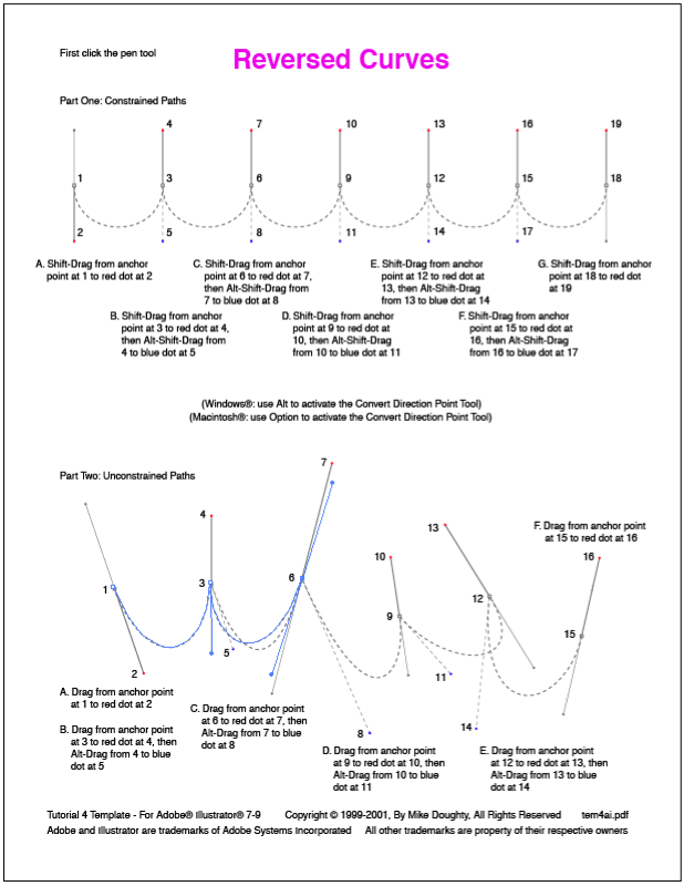

I wanted to make a schematic overview of my studio setup, the hardware of computers, hubs and external gear, including audio-, midi-, usb and ADAT connections.
So I tried vector drawing in Photoshop, but this wasn't flexible enough.
I bought a fat book about the use of Adobe Illustrator, and I'm exploring the technics at the moment.
Vector drawing, man I have to get used to it :-D
But I'm able already to draw a 4 part clover...
here's one sheet of some tutorials, they were to download as pdf files, but after loading them into illustrator you can use them as regular Illustrator files (after having saved it as a I. file first).
reversed curves.png (121.96 KiB) Viewed 1954 times

That's cool, quadratic beziers are fun! :wink:
I know almost nothing of mathematics, but I can understand that every line between two anchor points is calculated with one formula, with one ax determing the depth of the bow and another one the deviation from the middle point.
The position of the handles (length and corner) takes care of both factors.
't' is tangent?
great link, thanks :-)
The beautiness of maths :-)

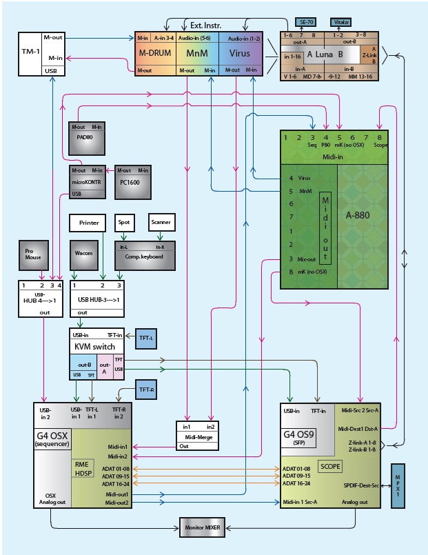

I made this studio setup drawing in Illustrator.
It's absolutely a non-technical and amateur picture, but for me it does what it should do.
I tend to forget about the details after some time, it helps with trouble shooting, and it makes you think about the best yet most simple solutions.
Working with two computers made things more complicated because of the extra ADAT and Midi routings.
Then there's a KVM switch for usb and monitor switching.
The Machinedrum uses the TM-1, a midi to usb converter, the MonoMachine and the Virus are pure midi.
The RME HDSP is great as it offers double midi in/out, a midi merge box adds an extra input.
Together with the usb inputs on the OSX mac these midi inputs make it possible to record all external midi sources in Cubase instantly.
Synth knob movements, microKontrol and PC1600 go directly to the OSX mac.
The A880 midid patchbay does the Midi to instruments routings, and the PAD-80 is merged with the main input (sequencer).
If I ever need to have Midi directly into the OS9 mac, I just have to switch to another program of the A880 to route the microKontrol to it.
Not all audio cables are drawn, to keep it a bit clean, but the Luna box tells it all (16 inputs from Virus, Machinedrum and MonoMachine, a few outputs to the external audio inputs of these instruments).
Scope is great, you can have it all :-)

Post by sharc »
Hey you forgot the kitchen sink Huub :lol:
Seriously though, that's a nice looking setup 8)
The chart could come in handy if you need to move house/rooms/play live etc. Good work :)

hubird wrote:Not all audio cables are drawn, to keep it a bit clean, but the Luna box tells it all (16 inputs from Virus, Machinedrum and MonoMachine, a few outputs to the external audio inputs of these instruments)
:-D

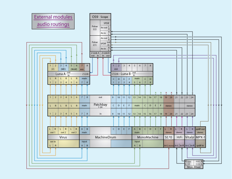

this chart was mainly for the Midi and USB (and ADAT) connections.
But it is possible to check the whole range of connections.
For the audio routings of the external gear I just made another chart.
Not really necessory, but I just love working in Illustrator :-D
To zoom in and have everything crystal clear is fantastic :-)

  • Great schematic hubird.

thanks Valis. So I don't have to feel ashamed too much about my hobby-istic approach? I really thought that :-D
Originally I made tabel based matrixes of connections for several units, with text indications of the connections, but it was more complicating than enlightening.
Then I decided to do it more graphically.
The use of colours is so useful, they are distinctive on their own.
It's now clear what are instruments, controllers, computers or 'utility' stuff like hubs or printer, in the chart above.
Also, using different colors for the cables avoids the excessive need of the curved 'cable bridges'.
Important was the arrangement of the 'building blocks', as it's better not to have too much line 'crossings'.
You should be able to see the flow of the signals in a wink.
@ Stardust: there was also an audio patchbay involved, hence I decided to keep the instruments audio connections in the chart above just indicative, as it would be too much.
So I made a separate chart which does those audio connections.
These are actually streight forward, so it wasn't really necessory to outlay them.
Yet it can be handy to check for mono or stereo status of the routing, and a few details regarding what connections have to be patched to either a not used Luna slot or to the analog-in of Scope.
The instrument colors are kept consequently along the routing, including for the cables.
Maybe some of you -with a more complicated setup- will be inspired to create something similar.
It's nothing compared with the real (drawing) stuff you are doing Valis :-)
I love that program tho, it's a joy to work with it :-)

ps: great charts, Huub 8)
hm, I forgot the digital connection with the Lexicon MPX...that is for next breakfirst then :-D
edit: spdif added :-) and no, there are no holes in the MachineDrum and the patchbay, it just allowes graphicly clean cable routing ;-)
