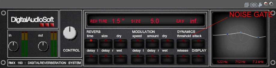

you can add dynamic process to the rmx ...
" in the air tonight " (toodoom toodoom toodoom toodoom toom toom ... ) gate effect guaranted ... 100 years !!! ;-)
just have a look at the pic below
cheers
olive
dynamic section of the rmx

Ypu were right, this works very well. RMX160 has a rich charcter of sound, which has to be there first.
I just clipped a hall down to the shortest time, ant the transients shut down nicely, no rings, or artifacts linger on.
Thanks,
BTW very little DSP due to the low amount of parameters needed. Nice.
