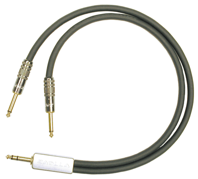

I just wanted to ask if the stereo analog i\o on the luna 2 are also require an adapter like the spdif output in order to be connected with a stereo device(which has 2 different mono input ports and 2 different mono output ports)?
there are according to the spec of the luna 2:
stereo analog input (trs unbalanced).
stereo analog outpot (trs unbalanced).
but only two ports are actually there.
Do i need an adapter to seperate each stereo into two mono channels\ports??
Thank you for your help.
Re: another question. stereo analog...
majistik wrote:Do i need an adapter to seperate each stereo into two mono channels\ports??
Yes. There are many different adapters available from music & electronics shops. Just choose one which suits your needs.

You just need something like an insert cable: a stereo 6.3" TRS jack to the luna and two mono trs jacks on the other end of the cable.
