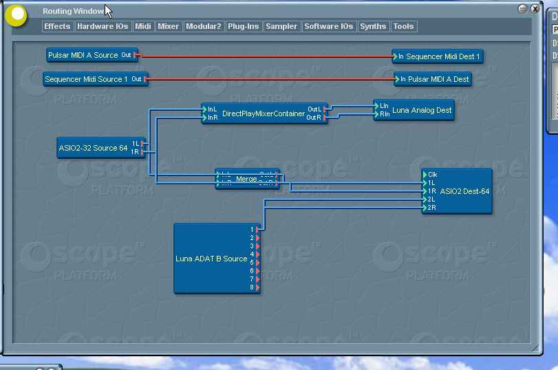

For some time Ive got a lot of Problems to Use the XTC mode (look here: http://www.planetz.com/phpBB2/viewtopic.php?t=21793). Now it works with my new Intel System, but I've got still one Problem:
I can't record with my ADAT Interface in the xtc mode. Cubase SE3 find all the other IO but not my ADAT IOs.
On the Picture you can see my actaully routing (I've got just 1 Micro on ,y behringer ADAT Interface).
Can anyone help me?

The way your project is set up is for 4 in/2 out ASIO.
Cubase SHOULD see 4 ASIO-ins.
Input 1-2 are set up to record playback (mixing down).
Input 3-4 are hooked up to your Luna ADAT B source. Is there a reason for you using the B-source and not the A-source? Could you have mixed them up?
What other IOs are you talking about? If you run the Scope ASIO-driver in Cubase, you will only get ASIO IOs. Cubase doesn't know how to communicate with your ADAT directly. This is what ASIO is for.
Now, if you want to record your ADAT source, you record from ASIO-ins 3-4; dictated by way you've wired your project..

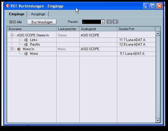

If I record with Cubase I cant monitor my recording and there is no input signallevel (only the Waves in the Sequenzertrack).
I sure this is an settingproblem with Cubaes but maybe someone knows the solution. The ASIO In is one ADAT track, the ASIO out is my analog Luna output. The ADAt Input is select as standrd Bus mono in.
If anyone can' help me again with this little Problem, I'm the happiest Scope use in the world :D
Here you#ve got the settings
VST Verbindungen.jpg (24.98 KiB) Viewed 3128 times

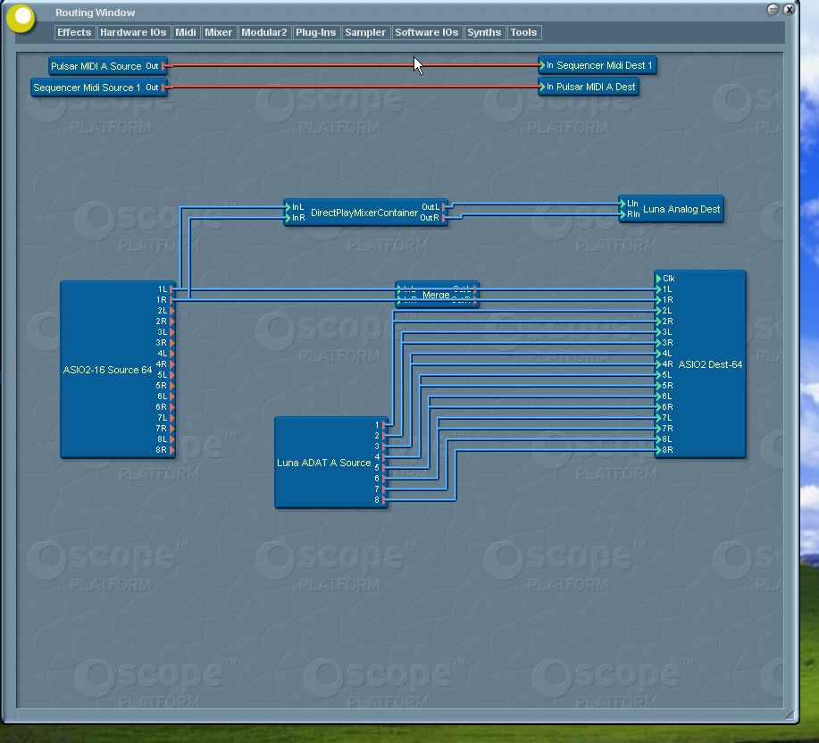

Here is my actually XTC Routing :D

you should monitor from the output of your Scope mixer, if you use one :-)
remember, you can always 'Y-split' any output, one line to record from and one to monitor from.
It's normal to mute the recording channel in Cubase, to avoid feeeeeedback :-
edit: oops, you're in XTC...
sorry, cant help, no XTC on mac.

Please seach board for Direct Monitoring.
"direct AND monitoring"
hubird, if input monitoring is turned off in cubase, you don't have to mute audio channels when you record.
right :-)

I've got one solution from the Cubaseforum: If I deaktivate direct monitoring in the ASIO settings I can hear my recording and have an VU -Meter Signal in the Audioout (thats enough...).
