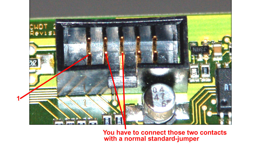

Hello!
I bought a Pulsar XTC board with 6 DSPs on ebay
but the Plug / Jumper for the 10-pin-sync-plate-connector is missing.
Does anybody know how I can replace it, what pins does it connect to each other?
Thanks a lot !!!

Symptoms are no XTC-operation and this error message:
"XTC plug not properly installed"

So far so good, but which pins are the ones to shorten ?
I´ve seen a photo of that some month ago.
It can be done with one or two "PC-mainbord-jumpers" !
Telmar
Posts: 8
Joined: Sat Sep 15, 2007 8:05 am
Location: Cologne
Post by Telmar »
Problem solved !
I got this pic from Ralf Bach (SonicCore) and he allowed me to post it.
Thanx to all who tried to help ! ! !

I've just checked the defeater key I had received from Creamware while trying to get the Pulsars working without I/O with another card...
Guess what ? It is only a simple plug with no bridges beetween any pin.
Could explain why I always got this "no defeater key" message....
A fake defeater key ? :o

UPDATE It's even simpler than what we thought !
See : http://www.planetz.com/forums/viewtopic.php?t=23331
