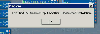

If I try loading Micromixer or Dynamic Mixer, I get this error message.
It's always something.
Picture 1.png (8.67 KiB) Viewed 1535 times

the "cant' find dsp file" error is an installer error. most likely the file is marked "read only" and unchecking "read only" should fix it. if not, delete the file and manually copy/paste it from the install files. if it's not where it should be, and the message is truly literal(unlikely), then copy/paste the file from the install files.
if you do a search on "can't find dsp file", you'll see the standard solutions. you can even remove the dsp file to the desktop(to save it as backup in the case of optional or 3rd party plugins that have special dsp files that might not be in the installer files) and copy/paste the dsp folder from the install files.
i don't know why this error happens, but it seems to happen mostly with the downloaded version, installed from a cd. i've never had a problem with the downloaded version installed off the desktop or with the factory cd version. perhaps it's a trick between the installer and xp.

Posts: 7789
Try the attached (and zipped) batchfile and see if it solves your problems.
FixAttr.zip
