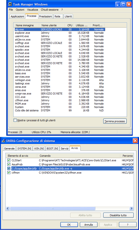

Autorun looks OK.
And I can't find out anything between running processes ( no audio software running in the screenshot ).
I wish to post the services list, but i've to translate it before. I'll add it next time.

What about all those servicehosts?
=ADDED=
No. svchosts have normal priority.
I've checked AsusProbe and it has normal priority too.
Just winlogon and csrss show high priority tag :-?
