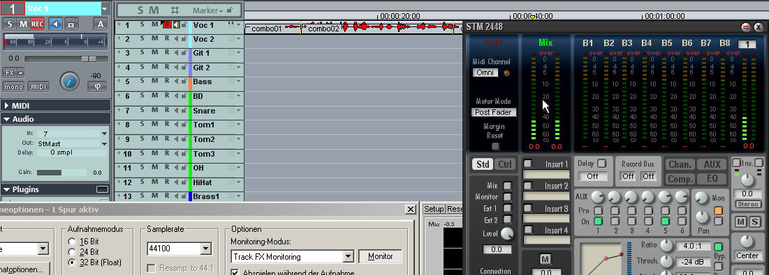

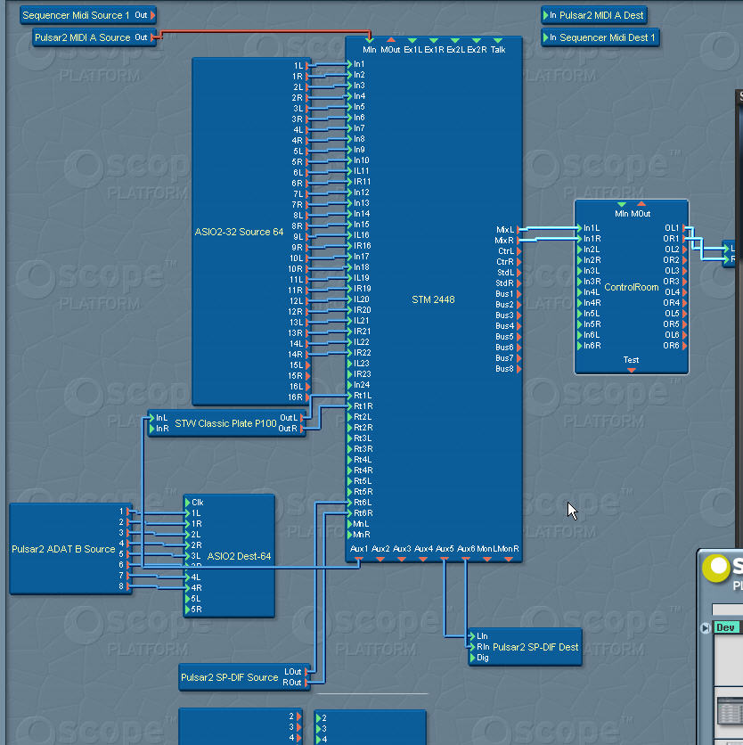

So here are screenshots from the scenary. While recording, Samp is the master for all overdubbing and punch ins. While mix down it is Scope. So I can start mixing while other instruments will be inserted later.

Only thing you need to bypass Sam monitoring is to send the ADAT sources to mixer channels as well. You can double the out cables and have each ADAT source connected separately to the Mixer and the Asio, so, for example you can send an unprocessed signal for recording but you can hear it at a different level or processed to help the performance. Seeing your setup you would need the 4896 Mixer, but you can also add a small mixer to the project just for the ADAT sources and route it to one stereo channel of the 2448.
P.S. Why that Control room? The mixer already has one, it seems a waste of dsp power...

I agree with alfonso that you could probably just use the 4896 mixer and a smaller mixer (instead of the control room) for mixing in the ASIO.at will.
This way it's all transparent to Samplitude and reduced CPU load.
I route incoming/recording channel ASIO through a small mixer and use the 4896 for mixdown.

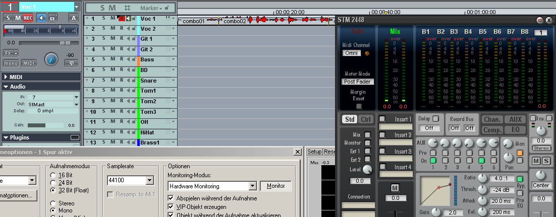

Another guy with the same confiiguration told me, that he has no problems with this kind of monitoring, so could it be a secret entry in the registry or something like that. To show you my problem here are two pictures first the option with Track FX Monitoring, than with Hardware Monitoring. You see in the Scope track 1 a signal than non.
