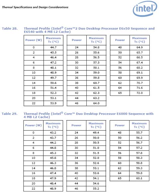

Just discovered one of the differences between E6X00 and E6X50 Intel processor series. Have a look at the tables below.
This is the link to the whole datasheet pdf
ftp://download.intel.com/design/process ... 327805.pdf

- E6xxxThermalDesign.jpg (46.31 KiB) Viewed 2554 times
