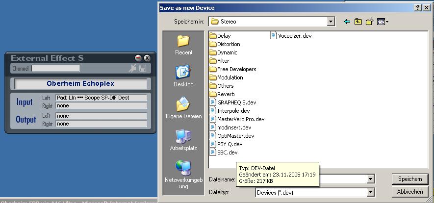

I recommend using the External_FX device from the effects folder.
Once you setup your effect with ins and outs, you can save it as
Oberheim Echoplex in your effects folder.
After this you can use your Echoplex as simple as a scope effect.
one time maybe as a insert and next time as an send fx or other combinations.

Post by hifiboom »
this one
