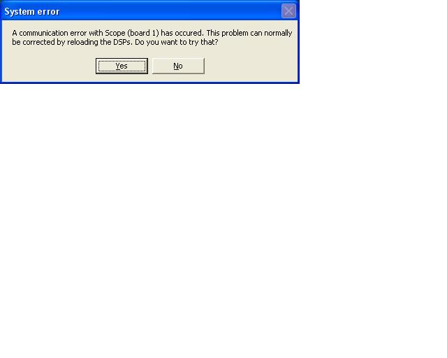

Nowdays I have got a lots of communication errors with my Pulsar2 and SRB (15 DSP) card. I have re-installed the computer a couple of times with same result.
Using both XP SP1 and SP2. Installed as ordinary XP, not as Standard PC.
If I press "...reloading DSP" it continues to load the plug but there is no sound for that plug. Mostly it is PRO-12 which does not work.
Have re-installed only PRO-12 too.
Not a big project either, STM1632 and PRO12 gives me 7.1% load in just one DSP of totally 21 DSP!!!!
I have fiddles around with different settings in cset.ini (all combos, both "empty") with same result.
It has worked before. I have removed the cards and STDM-cables to get rid of oxide too.
I have NOT tried to move PCI-slot yet, because of space in box.
My system is:
Asus P4P800-E Deluxe, I865PE, 2Gb RAM, Pulsar2, SRB, a lots of harddisks. EMU 1820M.
The Device manager telling me that Firewire (IE1394) shares the same IRQ, I have no connected HW to FW but I sometimes use it to my DV-cam.
Someone elso who have similar problem or a solution?

Hi synthetic,
I had some problems recently but not this one for a while, I reset everything and done the following... dont know if this will helps
1. Cleaned all contacts, reseated cards, fresh install (and replaced PSU?)
2. No sharing IRQ with anything... switch off any you arent using
3. PCI latency of graphics reduced to 92 or 128 (using doubledawg)
4. Increase PCI latency to 128 in bios
I think thats all.... these are the tips from planetz dwellers I recieved
Good luck
CGF
Posts: 23474
the FW controller shared with scope probably isn't a problem when you're not using fw and scope at the same time, but you'll probably want to move the card to another slot to try and get an unshared irq. there may be other devices to disable such as some of the extra usb controllers, but only if they conflict. the FW that is shared looks like one of 2. if itr is, just disable it and use the other FW port(looks like a FW card as well as a port on the motherboard).
if that message only comes up occasionally, i'd just do the reset and continue. a restart would likely help as well.

Have tried to move the cards with same result, it is ONLY when I try to load PRO-12 I got this error message, strange.
I tried to fill the DSP-power up with other devices such as:
- Modular3 (Kaegi synth)
- NordXTC
- Modular3 (OB-X)
- Modular3 (Poly wave synth)
- EDSI16i
- Minimax
- Prodyssey
- WC Pro-One V3
- ProTone
- Lightwave
- SB404
- Sixstring
And the DSP-power is now red, but no error message whatsoever, only PRO12 causing this and my Prohpet-Plus, seems that those plugs using some strange resources, anyone knows?
Posts: 8487
maybe the disk file is corrupted or the project contains some garbage related to the Prophets ? Can't remember a problem with one of them ...

Post by synthetic »
Now it's working again, seems that a DSP-file was corrupt, hope the fault will not return again. Now it's time to do some test on Wine Country's Pro-One V.3 which I borrowed from John last week. It has both SSM, CEM, Minimax and "ordinary" filters.
