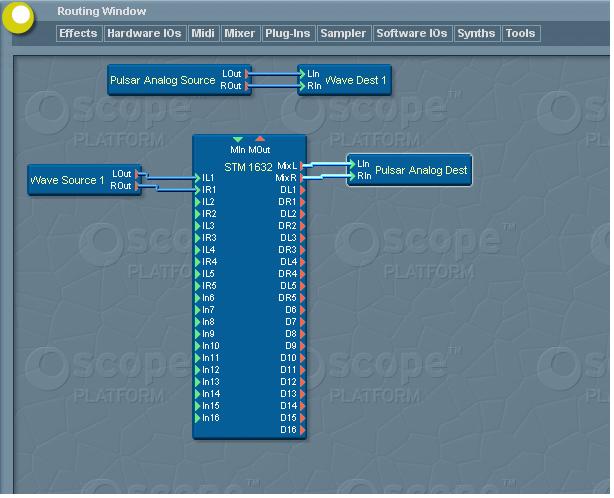

open the routing window hit print screen open your favourite image editor and paste it in ,save the image as jpeg and let us have a look It probably some sort of audio loop which is feeding back on itself.I'll give that a 3:1 chance.Any takers.

Hi folks, well heres a jpeg of the routing window...and yes, the problem still occurs even witht this ultra simple set up.

Post by Smiley »
Tried swapping pci slots yesterday :(.... still no change. Will try in different pc today.
Thanks for any help that and suggestions.

i've had this exact same problem, but I think only with the 24bit wave driver. I believe it's working ok for me now though, not sure how I "fixed" it. I'll try and look into it when I get back home tonight and report back. It's definitely not anything wrong with the routing though and I don't think it's a hardware configuration problem either.

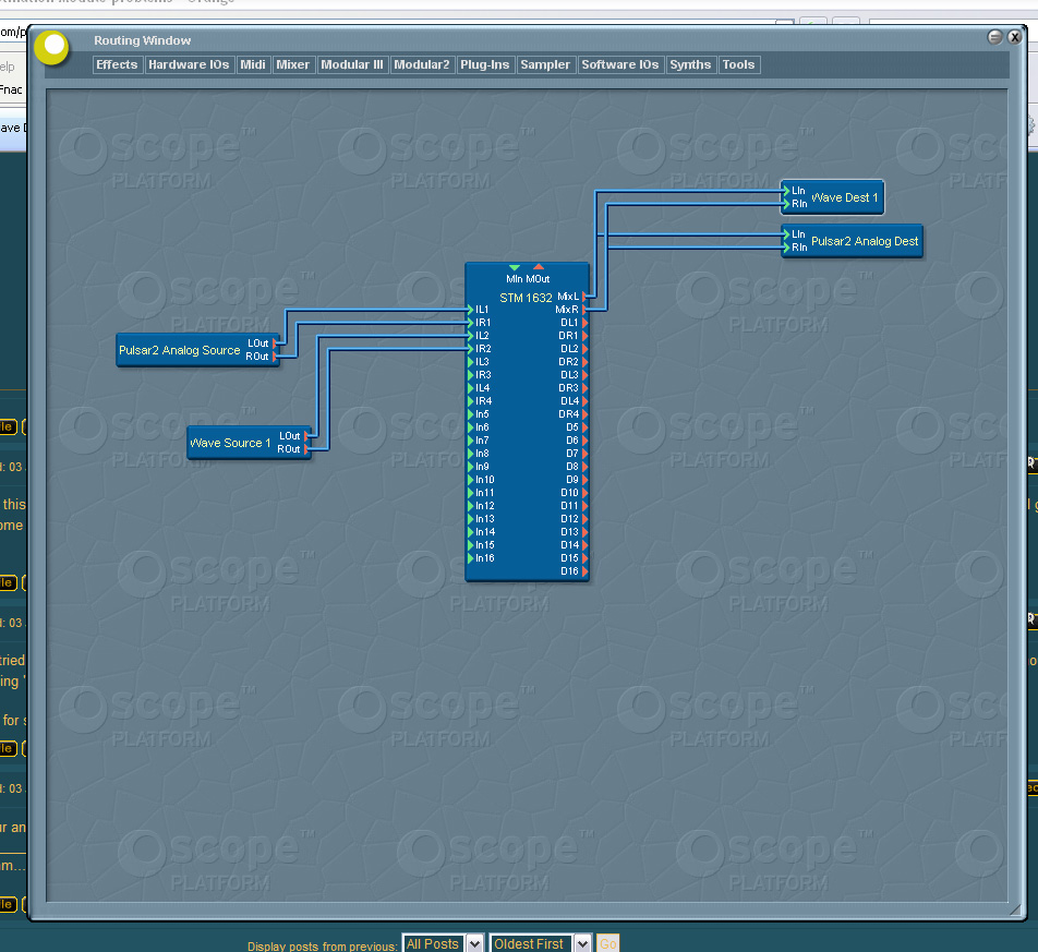

Put your analog source into the mixing desk and the wave dest in parallel with the pulsar analog dest.

I tried that too. Its been reduced to the minimum to try and identify where the fault is. Usually it would be connected pretty much as you suggest.
