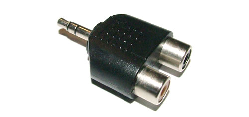

Post by ali »
Or this
mini jack adapter.jpg (2.89 KiB) Viewed 5463 times

Posts: 8467
well, if everything would be that easy... ;)
the cable with the ministereo-2RCA may (seem to) work, in particular if it's very short. But it can in no way be guaranteed - S/pdif requires a 75 Ohm certified cable, and afaik no such thing exists with the connectors shown above.
the usual approach would be to use the adapter from picture 1 plus 2 certified cables for digital audio.
The (cheaper, often yellow jacked) 2xRCA video cables for 'multimedia' also seem to work (at least they ARE 75 Ohm).

If you want to send the s/pdif signal to your monitors, you'd need the adapter anyway, as it's just one (output) cable and the (first) monitor passes it on (at least on my DS30).
