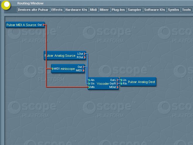

I wanted to try out the old Pulsar 2.01 Device Vocoder II. and it doesn't work.
Has anyone experiences with this? Or is it just that it doesn't work with sfp 4.0?
Project routing.jpg (36.55 KiB) Viewed 2835 times

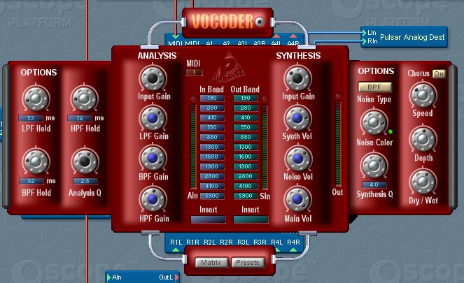

this is vocoder II from an old pulsar software version
it looks like this :

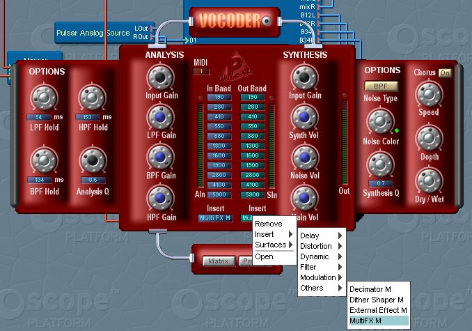

I know a workaround for this one:
Load something in the insert slots and then bypass them

hi lima,
can you make an illustration of it so my f***** up brain can sort that out

Hi,
I can answer for him...
Just Load some Insert FX (e.g. Multi FX Rack) into the integrated insert slots of the vocoder II, and it will work.
regards, Oli.
Lima
Posts: 917 Joined: Mon Dec 29, 2003 4:00 pm
Location: Italy
Post
by Lima » Fri Apr 06, 2007 2:09 am
Exaclty!
