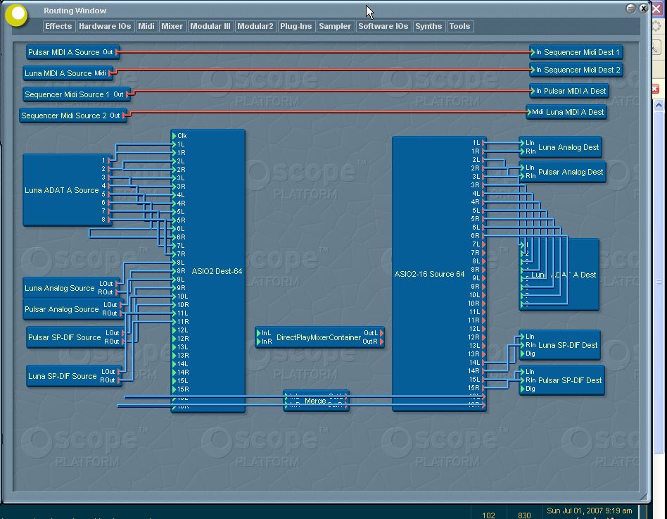

I've used the XTC project for routing but the XTC Effects are still brown colored :(
I Think, there could be two reasons:
1. My routing is still wrong - so I atached a screenshot of it (the effects at the ADAT Interface are just for the Vocalrecording - not for XTC)
2. Maybe I've got problems with the Effect devices - must all XTC and normaly VST Effects in one directory?
Scope Project XTC Cubase.jpg (114.94 KiB) Viewed 12309 times
you have to rename all .dev extensions to .mdl (or the other way around) and put them in the VST folder.
No XTC on Macintosh, so I don't know exactly the ins and outs.
Try a search on planetz for something like XTC renaming trick, maybe it is in the tipps and ticks forum.
Someone will help :-)

mediamalte
Posts: 59
Joined: Sun Mar 18, 2007 9:59 am
Location: Rastatt/ Germany
Post by mediamalte »
Thanks for the tips
I renamed the devices with the "XTC_converter" and copied them in the XTC folder but they are still not activ. Even the vzrecording is list in Cubase but if I want to start it, cubase can't find the sampler :-?

it works with that version of cubase in xtc mode.
that xtcproject.pro won't work. you don't get scope mixers and effects inside the project like that for xtc mode. you load effects in the cubase mixer in xtc mode, you don't get as many routing options, that's what it's for(although there is a trick to use the scope mixers in xtc mode). what happened to the original?

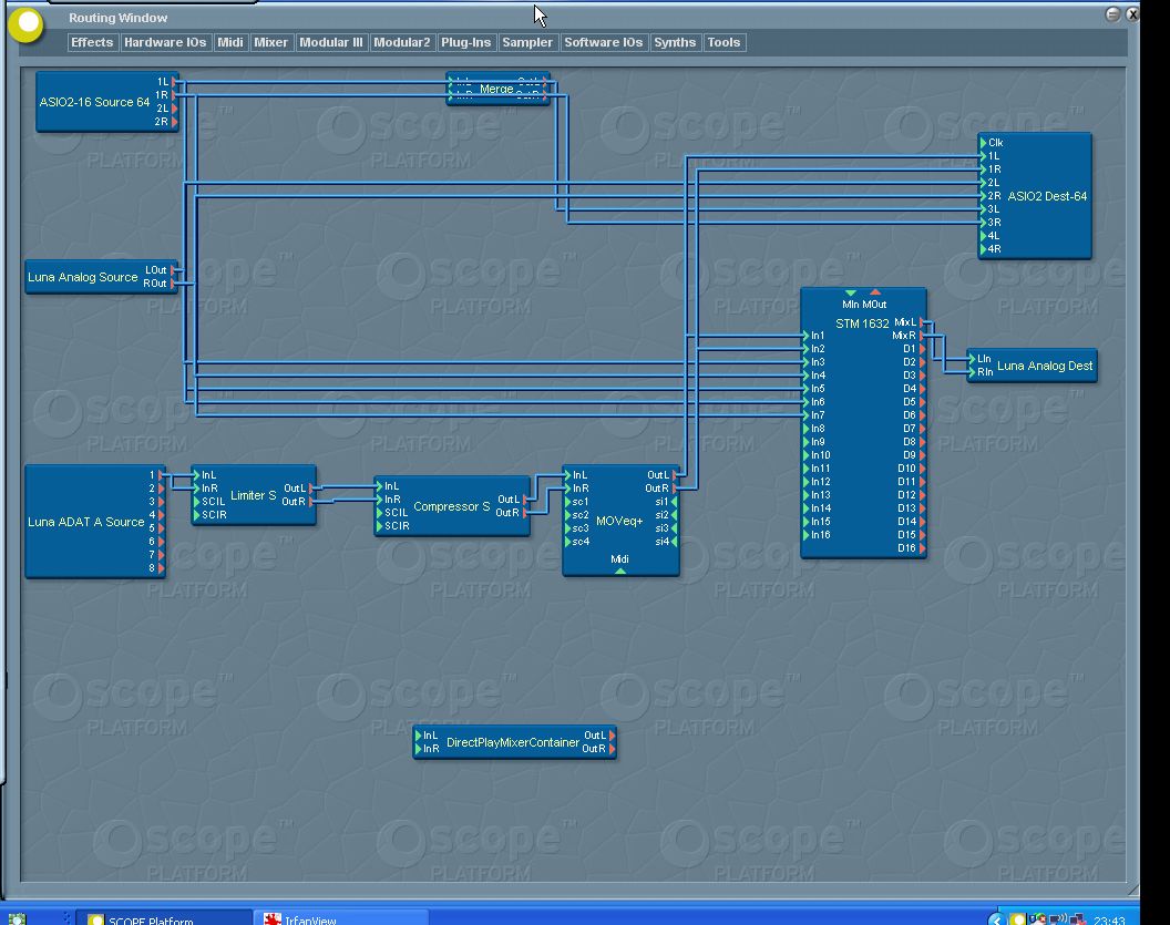

mediamalte
Posts: 59
The Porblem hasd changed again:
Know I can hear and record and the effects are not disabled, but I can't use them.
If I close Scope and start Cubase - the software can't use the Scope ASIO. If I don't close Scope ASIO is there and Monitoring and recording too, but the PlugIns are useless....
Here is my Routing:
