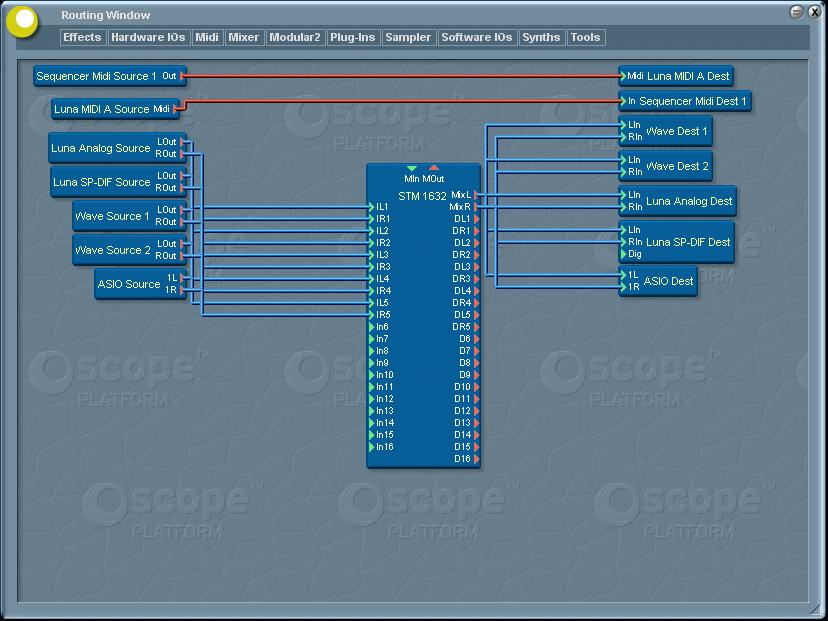

Any chance you could give me a screenshot of what the routing should look like for the amplitube standalone to work? I've attatched a shot of how I have it set up now.
I don't have Sonar or Ampltube, but you have to realize that the ASIO protocol permits only one 'client' at the time.
The source modules are a different story, I'm talking about ASIO only.
You could load Amplitube as VSTi in Sonar.
You just have to check your latency settings in Scope and Sonar.
As long as you stay under 25 ms for the whole setup you won't notice I guess.
you know you can add ASIO channels by doubleclicking the ASIO Source module?
For both in and out!
Use always the same (couple of) ASIO drivers, preferrable ASIO2 (allowing direct monitoring, but forget about that now).
You got the picture already I sea :-)
You are listening to the mixer's out now, taking the view that you have connected the analog out of the card to your sound system (amp, mixer).
If you record the incoming audio from -say- a Scope synthesizer -played life by Midi- from the mixer's out via a ASIO channel to Sonar, you will also record the signals coming already from Sonar, f.e. your Amplitube playing life by recorded midi or as an audio file already.
Therefor, you can output every track inside the mixer, by muting the channel from the master outputs, and sending them to the Direct Out (check the manual), which you find back on the mixer module in the project window.
There are other possibilities, it depends what you need to include in the signal.
It's just to show you the picture, how to think.
You will never be out of cables in your studio ;-)
Why have you the mixer's out connected to SPDIF out?
A good use of that output is connecting it to a auxilliary (effect send) of the mixer through to an external reverb with digital ins like the Lexicons.
Midi perfectly done :-)
Hope Sonar will do, there were some reports about ASIO troubles or something, not sure tho.
If you click on 'Int.' on the AUX page of the mixer, you can make connections from the pop-up menu, and the module image starts showing the activated aux(iliary) (effect send).
sonar is great with scope.
hubird is right, asio is not multiclient. you can only use one asio app at a time. you must use the vst version with sonar. please read the manual, the project you posted is the "dummy" project that is just to let you have some quick fun. for best results you need to be able to edit it. asio ins and outs can be added by rght clicking on the module and choosing "surfaces" and then "asio settings".
hubird wrote:Midi perfectly done :-)
silly me :-D
Thought, a tight look already...
long time go I saw that project :-D
