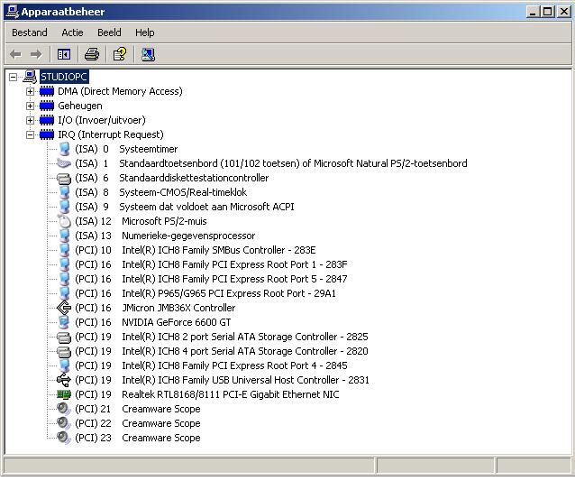

how do you know that your cards are not sharing irqs with anything?

My Cards are not sharing IRQ's with anything... They are at 21,22,23 (see attachment)

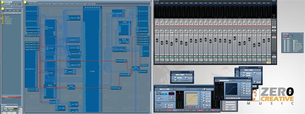

I'm now gonna try what will happen when all STS samplers are removed from the project file (see other attachment)
This Project Hangs within 10 minutes (only when the sequence is running!)

My Hardwar IRQ config
