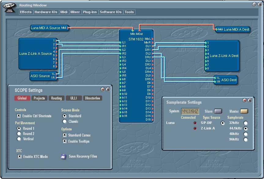

the power on the Luna box if connected to the scope card will light up as soon as you have a Zlink source or Zlink destination present
drag and drop a Zlink destination or source you will notice the power light on the box becomes green
you need to make sure you treat this like real hardware. If it is present in the routing window and connected properly it should make sound

I am still having no luck but am reading the manual and PDF today. I have attached an image of my scope setup. I have a source and destination present for both ASIO and Zlink but no lights on my Luna box.

Ignore that last post. I am such a registered idiot! I knew it wasn't this hard the first time. Everything works fine, I had my Z-Link cable upside down in the card port. Doh! (I did not even think that was possible.
