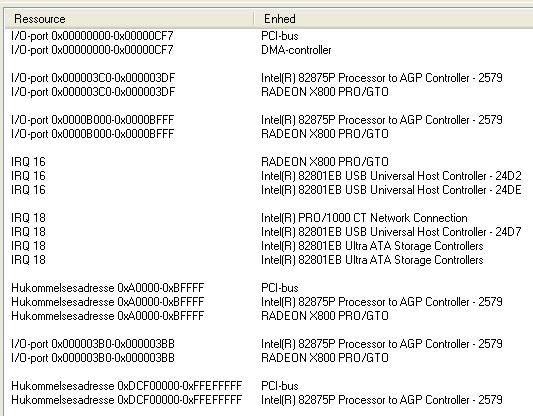

oh, so you have an irq shared with usb?
you don't have to disable all the usb ports, in fact all of them will likely work after you disable the controller that is sharing....that is, assuming that i am reading you properly.
there's no magic involved. it's mathmatical the way the thing works. if you set it up properly, it will work properly everytime. i've put together many machines, i can assure you it works like that. don't just disable stuff though. you need to disable the right things and leave the things you need. i'll help if you need it...

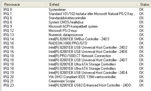

garyb : i dont got any IRQ share problem with Scope and usb
Pci Port 5(i think its there too lazy too open pc) is not supposed too share with anything , took some screens of it , my OS is in danish soo i hope u still understand it
astroman: on the Scope card there is 15 Dsp's but in SFP it says i got 14 dsps. and i have been able too fill out my scope card one or 2 times before with masterverb's . So now im even more confuzed than before i posted the help LOL

it's normal that a 15 DSP card shows only 14 active chips - one is used to control the others
I'm almost certain that you have the original Scope card with generation one IO system - if you open the latency control panel and you cannot select a rate below 13ms at 44.1k then it's generation one, which cannot do more than 5 masterverbs due to it's way of PCI bus handling.
