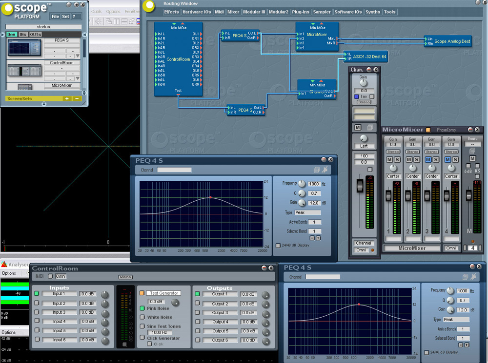

I don't want to know why few members have decided to try to spoil me and my compagny ,but here are TRUE TEST.
Is POLTEQ a PEQ4 ? NO !
Is the DAS 4BEQ a PEQ4 ? YES !
You will find screenshot ,2 pulsar project and the DAS PEQ4 made especialy for this test with the original 4 band atom.
another post...for example...
- PHASE EQUAL to -180
- DAS-4BEQ-VS-PEQ4.jpg (193.74 KiB) Viewed 6537 times
- PHASE NOT EQUAL to -180
- DAS-POLTEQ-VS-PEQ4.jpg (241.66 KiB) Viewed 6538 times
Last edited by digitalaudiosoft on Sat Dec 23, 2006 11:12 am, edited 5 times in total.

THE 2 PROJECT AND THE DAS 4BEQ ( FREE )
-111 DB for DAS 4BEQ and - 40 for POLTEQ...
HOPE NOW, THAT EVERYBODY WILL UNDERSTAND THAT IT'S NOT POSSIBLE TO STAY COOL WHEN FEW MEMBERS ARE ALWAYS ON ALL DAS POST TO WRITE BAD THINGS.
BYE
ERIC
BYE
ERIC

would you mind to explain the 40dB difference between the DAS 4BEQ and a PEQ4, which are supposed to be identical.Posted: Thu Dec 21, 2006 7:54 am Post subject: OFFICIAL POLTEQ TEST
[snip]... ,but here are TRUE TEST.Is POLTEQ a PEQ4 ? NO !
Posted: Thu Dec 21, 2006 7:57 am
[snip]... BYE ERIC
if I use 2 PEQ4s I get -155 or so total cancellation, so the 4BEQ is by far a PEQ4...
Too fast ? here's the replay
you copy a device and make a test
the 2 candidates cancel each other by -111 db
on the other hand a true clone would cancel at -155 dB
you decide (by definition) that the 2 are identical nevertheless
thus accepting a 40 dB deviation still a proof for identity
as an irony of fate -40 db also happens to be the difference between the next 2 candidates, but this time supposed to be different
picture: it's magic... (meg ryan drives through the night in 'sleepless in seattle'...)
I know what kind of scale dB is and that -111 is a little bit softer than -40, but your balance lacks
(I'm not at all interested in the devices, but the math and the leak is interesting)

no need to polemic again and again and again.....astroman wrote: would you mind to explain the 40dB difference between the DAS 4BEQ and a PEQ4, which are supposed to be identical.
- lisajou perfect -180 ,no point around the line and -111 db about level cancellation.
- PEQ4-VS-PEQ4.jpg (276.02 KiB) Viewed 6298 times
Last edited by digitalaudiosoft on Thu Dec 21, 2006 6:28 am, edited 1 time in total.
