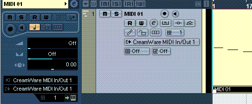

and in cubase
Cubase rout.GIF (19.7 KiB) Viewed 28903 times

It doesn't work man..
Can you help me finding the problem?
Cubase showing that there is a sound, and still, not a sound..
See picture -
Thanks alot.
The module Pulsar Midi A source points to the hardware Midi input on your Pulsar card...
Use the Midi sequencer module instead to connect to Cubase.
You should study the manual for a while, it's explained very well.
Midi is not ASIO by the way, Midi is not 'sound'... (you say 'Cubase showing that there is a sound, and still, not a sound..').

arela
Posts: 858
Location: Norway
Post by arela »
Like Hubird says:
You can combinde this with the midi merger.
Pulsar midi > synth let you play the synth thru scope, and you can record midi to cubase, while seq midi to synth plays your cubase midi track with scope synth.
You better change Cubase MIDI IN to NO MIDI SOURCE when you have finished midi recording, or you might se a midi loop
i forgot; connect Seq midi dest to merger

Thnx it works!
Happy happy happy:)
The manual doesnt include cubase configuration in it.
The biggest problem was how to configure in cubase.
