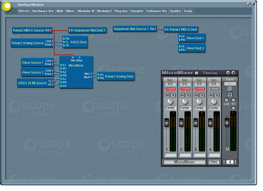

this is a great tool for testing your configurations latency
http://www.thesycon.de/deu/latency_check.shtml
you might want to check it with a low level scope project.
for comparison:
i have an absolute max of 28µs

ok,ok...
when moving a window it´s 29µ :D
but it depends on what scope-project your running
