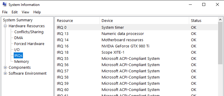

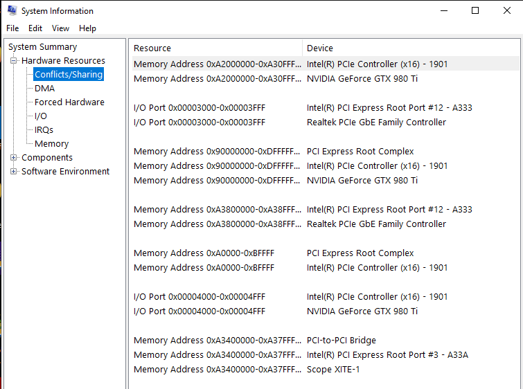

Right. Now we also shouldn't have to worry about PCI overflows as a cause either. Is the Xite sharing with anything, physically or address range wise?

Valis, I've now removed the PCI-cards from the new build and the conflicts/sharing and the IRQs now lok like this:
