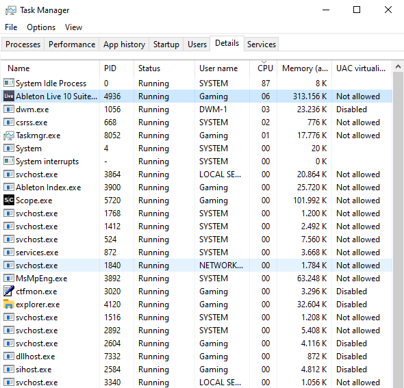

to check for a background app issue, open the task manager when there are problems, go to the "details" page and look for anything using significant cpu that is not your audio apps.

About the IRQ's what I meant was that the IRQ that the XIte is on is only shared with one of my SCOPE-PCI cards, which I believe is ok?:
I havn't been able to detect any CPU spikes or locate any suspicious processes when I hear a pop. Ableton is the most CPU hungry: 5-10%, nothing else gets over that:

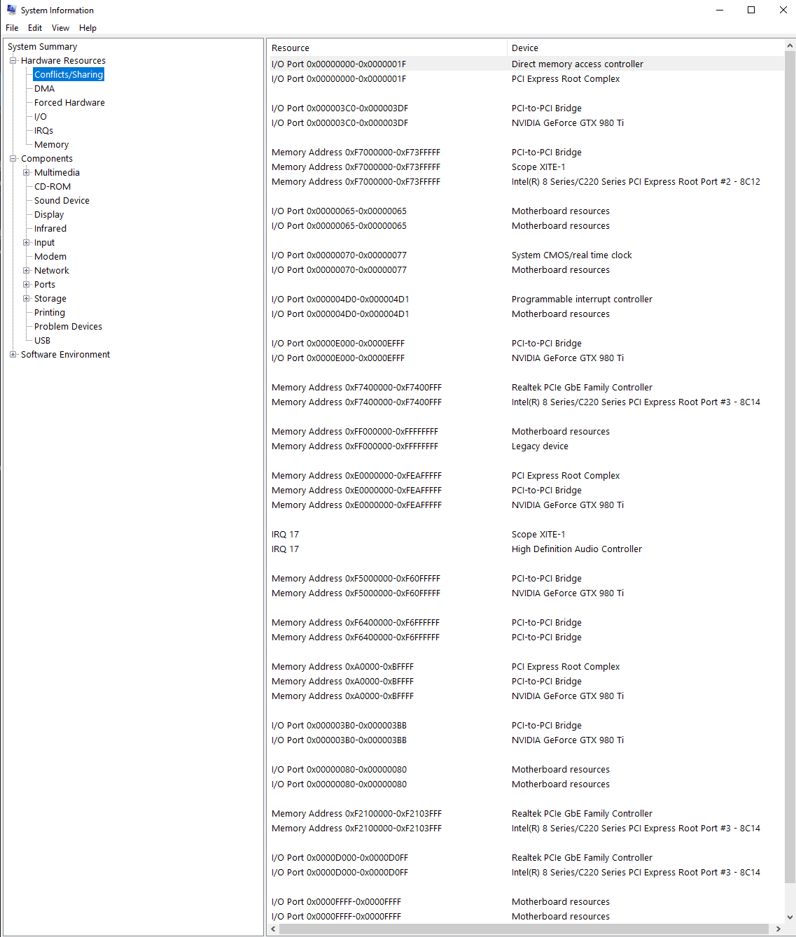

check for irq sharing in system information, not the device manager.

Re: How to optimize windows 10 for Scope to avoid clicks and pops!?
If the onboard sound is the only thing shown to share with the Scope in System Information, it's fairly easy to disable it right there and see if there's any change with the driver not accessible...

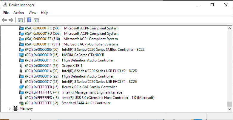

I guess this is where you suggest to look for IRQ-sharing?
No power is being drawn out of the ordinary: Fridge (it's on a different power group though), this computer.
It is not the onboard sound that is sharing the IRQ of the XITE, it's one of my SCOPE PCI cards, but I haven't installed the drivers yet.
disable HD Audio Controller IRQ #17.
I doubt it´s your SCOPE PCI.
"HD Audio" normally means "Realtek" or such.
I hope I´m right ...
You are right. I just checked my "trash" installation that I have running on a different HDD and the HD Audio seems to be the onboard. There's also a Scope card, but they aren't shown on the new installation since the driver hasn't been installed.
I'll disable both HD audio audio controllers and cross my fingers.
Well, it seems to work better now, but I still get a few clicks from time to time.

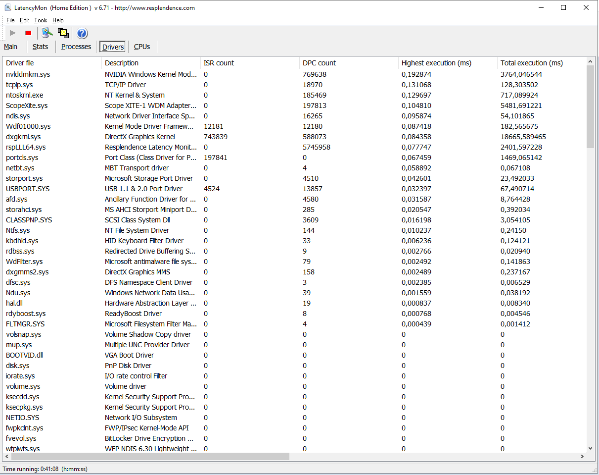

There may be other issues. Have you run DPC Latency Checker?
Also, there are tools that can check our drivers and software for updates, I used to use Secunia but now it's Sumo and a few others.
Nope - that is something I am not familiar with, do you have a link to a guide on how to perform that test and what to look for?

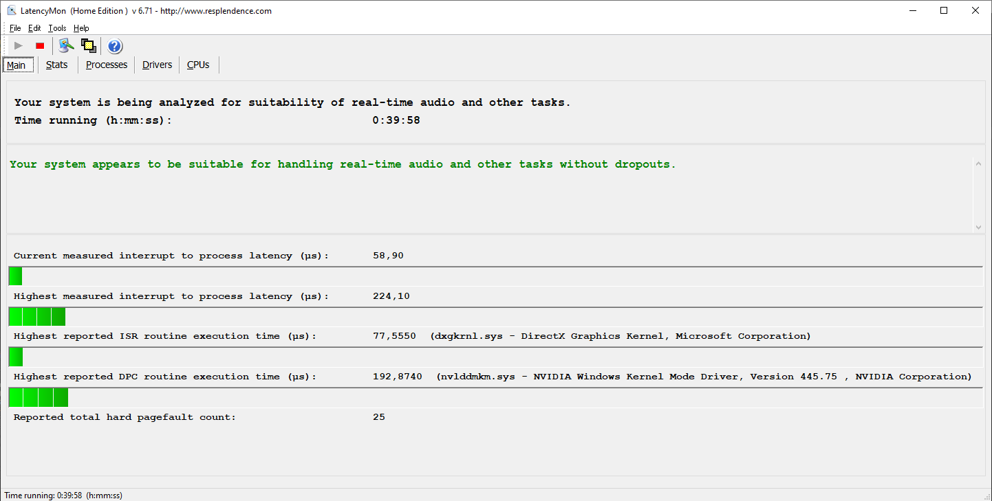

Thank you for helping me hunting down this problem it is very much appreciated!
I ran the Latency check and it reported that I had some issues, and it made me focus on my GFX card. Searched the web for a solution and ended up finding out that the GFX was still throttling, so I did this:
Set NVIDIA Graphics -> Manage 3D Settings -> Power Management Mode -> Prefer High Performance
And ran the latency test again, which now looks much better. I almost had my arms over my head in success and then: pop...
LatencyMon looks like this now:
Not sure what to try next?
